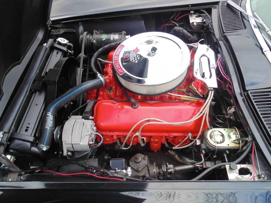

    Looking to upgrade dads 427/390 auto with C60 with a correct oval port tir power intake with the correct dated carbs. My questions whats the difference between the center carb from a auto to manual. I have a feeling finding a correctly dated center carb for a auto will be difficult. So can someone convert one. Also can you easily spot a repro intake from a original one? We will looking at doing all this at Corvettes at Carlisle I know this isn't ideal but we are old fashion and like too feel things before he buys. any tips or pointers will be helpful.
    If it matters last year the car got a regional Top Flight and dad is done going for ribbons.

      I acquired a reproduction intake for a L71 recently. Nice piece. I did not use the original on a engine rebuild because I had to have the intake shaved, so I got a repro. In your dad's case, I'd suggest a repro as he's doing a re-creation so to speak.
      As far as the 3 Holley's go, I'd also suggest the dated repros, especially since finding good dated original units will be both time consuming and expensive. Then the rebuild/restore costs. Again, since the car won't be judged, is it really necessary to have them dated "correct"?
      edit.......undated repros. Seems decent $.

        Dad has in his mind he wants dated carbs. I'm trying to talk him out of it. I wasn't sure if the repro intake is a good peice. I'm concerned about leaks once installed. Having a 3x2 car will fulfill his dream. I just don't want this to become a nightmare.
        Joe we are not concerned about making power. Just having the look of a 3x2 car. And trust me I'm not sure this is a good idea too. I just trying to help him by getting advice from people who has owned them and worked on them. Also as much as I enjoy that forum when it comes to some issiues I trust this forum a tad more. And I know I won't get juvenile responses.
