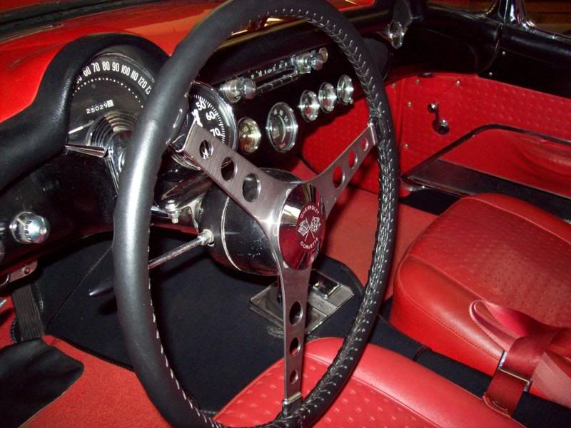

    I have a '57 (below) that I restored from the ground up in the early 90's. It has a close ratio M-22 transmission which I have to keep. I made a mistake of ordering a rebuilt 4:11 rear from Chicago Corvette, the gears are just too high. It has great take off from a standstill but the engine is screaming at 60 mph. I want to lower the rear gears to maybe 3:55 or 3:70 but not a 3:08. I want to drive a maximum of 75 mph and keep the engine revs @ 3000 rpm+/-. Also is there a vendor that sells a used rear carrier that I can trade my 4:11 in?
    Thanks for any advice. PT
