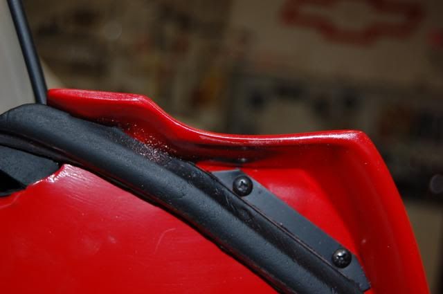

    What's the difference on those between coupes and convertibles? My guess is at the top of the rear of the door where they interface with either the convertible top or with the coupe fiberglass. A picture of each with the difference would be extremely helpful.

    Hi Mike,
    Here's some pictures of that area on a 71 COUPE.
    Perhaps they'll help?

      Thanks, Alan. Since I have a convertible weatherstrip here, I can see the difference. The convertible has an extension with a vertical u-shaped channel for the very rear of the window.
