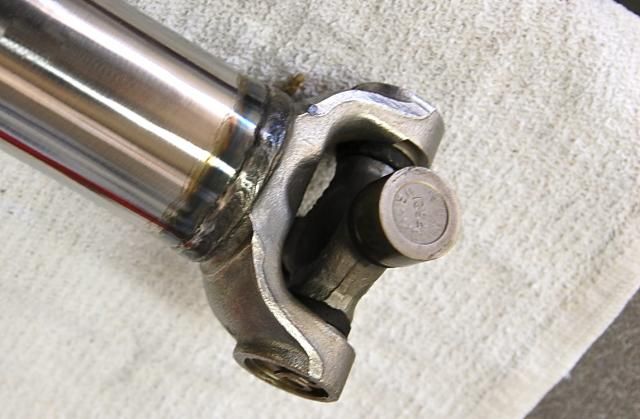

      Hello Gary and Mike. Here's a pic after Gary's propaine torch.

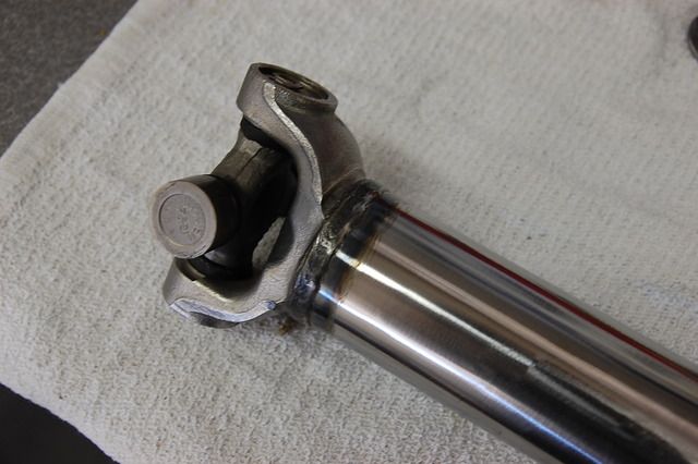

          Here's a picture. 71 drive shaft.
          I really wondered if the 'bluing' is mimicking the original heat zone or actually making the original heat zone visible again?
          I'd be interested in knowing how people duplicate the weld seam's appearance and the extrusion marks.

                  In the pictures above how are you guys getting your half shafts and drive shafts to look like that? Are they being turned in a lath? A curious mind wants to know.

                              The shiny one shown earlier is way overdone, but that's already been mentioned.
