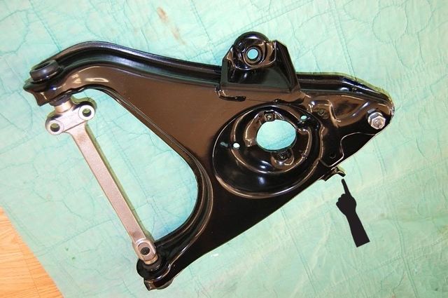

      As Alan pointed out the ball joints were riveted but the replacement ball joints are usually bolted in. One of the lower bolts is longer and acts like a stop. If you want correct they should look like the ones shown in Alan's picture.

        On my 71 all 4 rivets (2 each side) are the same. A longer rivet isn't used.
        There is a 'tab' welded to the arm that acts as the 'stop'.

          Yes, I don't know why the special bolt with integral "stop" was included with Corvette SERVICE lower ball joints. I suspect the "hardware package" included with the ball joints was somewhat generic and some applications actually needed the stop. For Corvettes the stop feature of thebolt was superfluous but caused no problem.
          By the way, the basic upper and lower a-arms for Corvettes were the same from 1964 to 1982 (1963 was basically the same but did not include a reinforcing plate on the lower a-arms). However, there was one difference for 1978-82 related to the lower a-arms and that difference involved the stop bracket you pointed out. For 1978-82 the stop bracket was slightly reconfigured to accommodate the 255-60-15 tires optionally available during those years. During these years all Corvettes got the lower a-arms with the revised bracket whether they were equipped with the 255-60-15 tires, or not. Also, in 1980 the 78-82 lower a-arms with revised bracket became SERVICE for all 1963-77 Corvettes.
          The difference in the 63-77 and 78-82 stop brackets is quite subtle but there is a difference. Shame on any 63-77 Corvette owner audacious enough to show up for judging with 78-82 lower a-arms!
