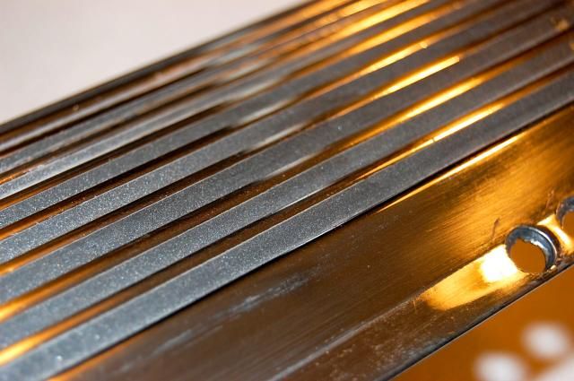

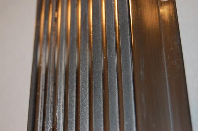

      • 3418
      Re: 1969 N14 Side Exhaust Cover Question on Finish Between Fins
      Hi Steve,
      Here's are some pictures of the paint on a set of side exhaust shields I bought over the counter early in 1971.
      The paint is a LITTLE darker than it appears in the pictures, but does display the 'facets' that catch the light. that you see.
      If all other sources fail I believe the dark phosphate paint that Eastwood sells (10281Z) is a good alternative.
