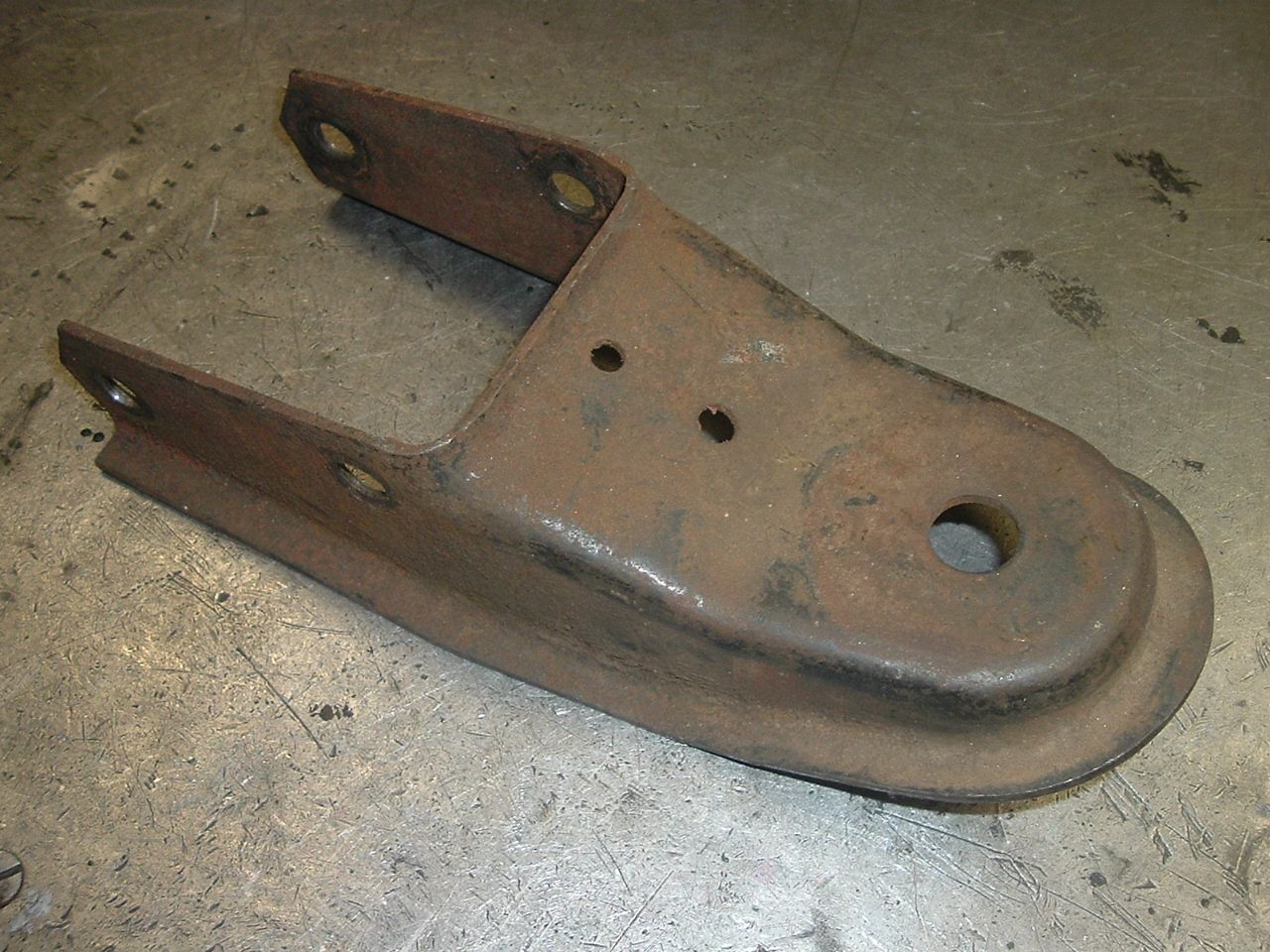

    It appears that the only differences (besides ~$100) between the two are the 2 drilled holes along the top. Does anyone know the sizes of the holes and measurements that I could use to 'manufacture' a '63 out of my '64?

      I have one around here from a 63 or 64, in addition to what Joe stated they are thinner gauge metal then the later brackets. If there is something you want to me to look at let me know and I'll see if I can dig it up.

        I believe the only difference is the two holes you mentioned, they are for the emergency brake cable routing on the 63. The 64 has a different cable layout. You could drill the holes and have a usable 63 style bracket.

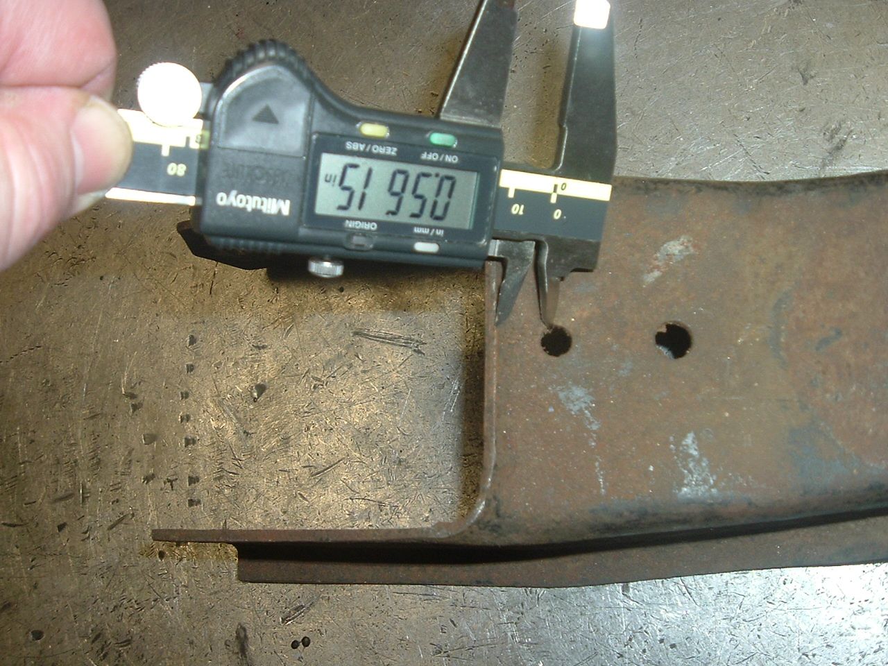

          Thanks Gary....if you could, measure on the '63 from the crease marked by the arrow in the picture to the center of both holes & also the size of both holes. I would greatly appreciate it. Thanks a ton.

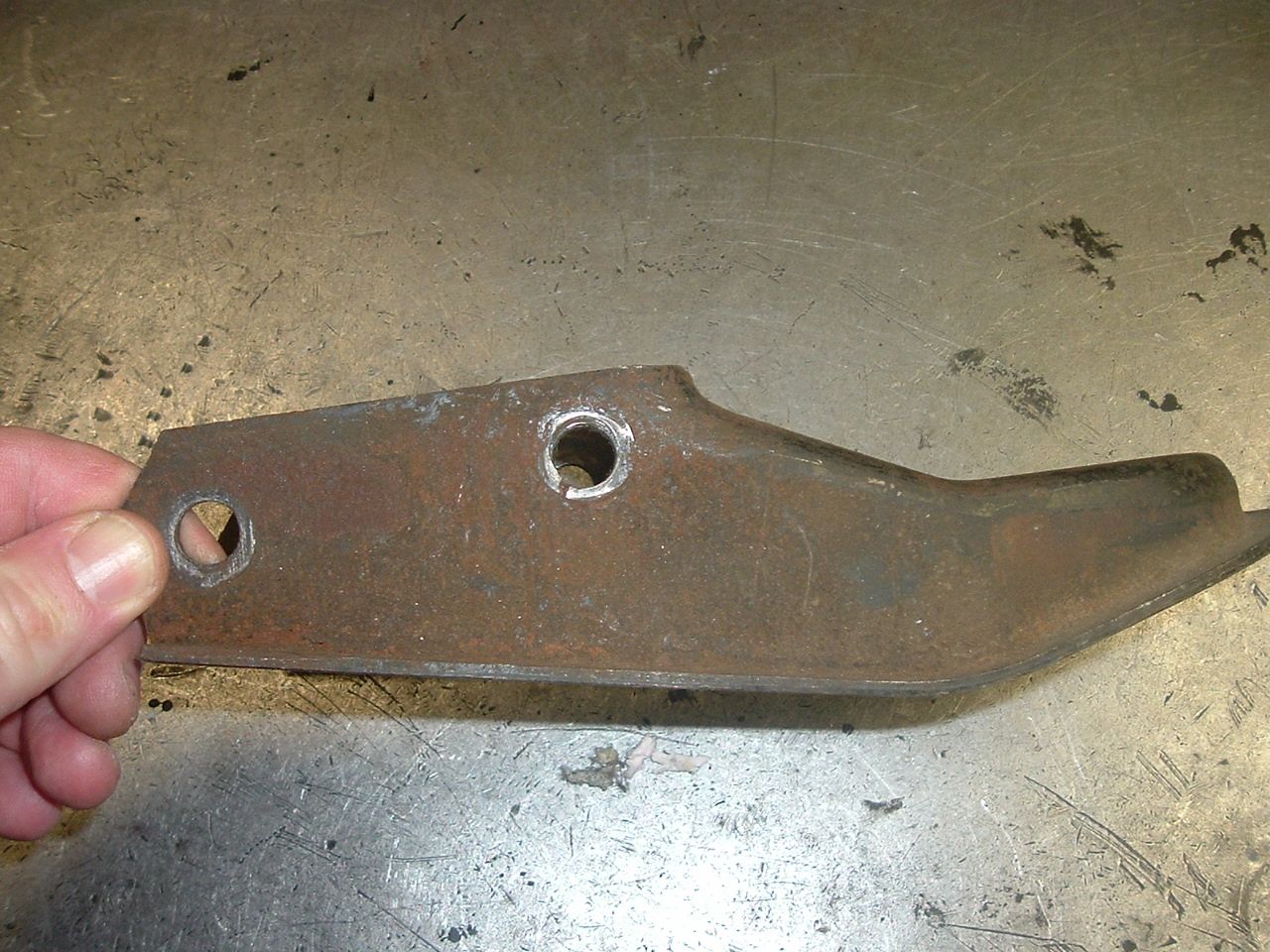

              Ok I found it.
              The holes are different size stampings. The back hole is .285" and the front one is .342" The lip to the back hole is .561" 1.030 center to center.

                  I have to say that is interesting reading, but I have been able to drill through the front holes to convert them to the double through bolts the later diff's used. I wonder what the concern was not to recommend this? Core shift in the casting? The ones I drilled out were fine.
