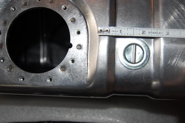

            I thought that 70 model year gas tanks without EEC provisions still had the 'button' relief valve located near the provision for the filler neck?
            Regards'

              Re: Gas tank on '70 makes "woosh" sound when removing cap. Normal?
              I can confirm that 70 original tanks do indeed have the relief valve.
              Bill

                How does it work? Does it open when tank vacuum reaches a certain level?
                Is there a way to test it? I imagine it's probably near impossible to reach or even see it with the tank installed.

                        • 3418
                        Hi,
                        Actually the button valve is near enough to the filler neck that if you flatten the rubber filler/drain boot you can see and reach it, and if your hand is small enough you can reach it's other end through the filler neck.
                        You can test it's operation that way, but of course have no sense of at what pressure it opens.

                            ... You can test its operation that way, but of course have no sense of at what pressure it opens.
                            Alan, how are you suggesting the vent valve be tested? By pushing it back and forth from each end?
