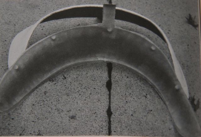

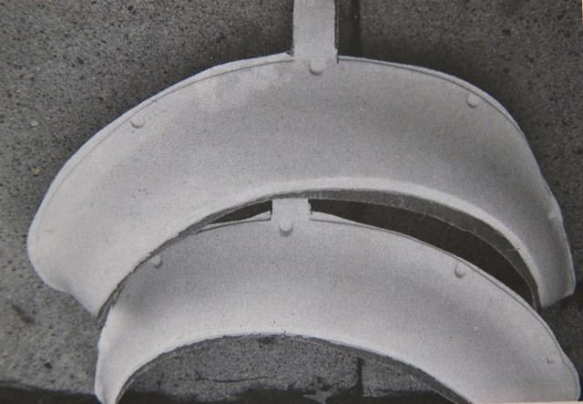

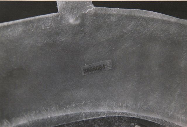

        Hi Marc,
        Here are some pictures from M.F.Dobbins 68-72 book.
        Might these be the type of flares on your car?
        Note the 'tab' Patrick describes.

          Re: C-3 Fender Flares
          These are exactly the flares I was trying to describe. I think they came with an L-88, but you could order them at the dealer. They were pretty crude looking. I did not remember the paper part number tag imbedded in the glass, but I was sure there were no raised numbers from a mold like GM regular production panels which are of much higher quality.
