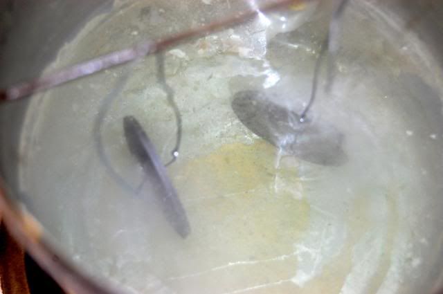

    I've been doing both light gray (zinc) and dark gray (manganese) phosphating (parkerizing) with supplies I buy from Owens Group dba Palmetto Enterprises.
    The process involves heating a bath consisting of the phosphating liquid and water in a glass or stainless steel container to about 200 degrees, (I use a hot plate), and immersing the part in the bath.
    The part you want to plate must be scrupulously clean and grease free for best results.
    After the part is phosphated it is rinsed, dried, and coated with some sort of oil based protectant.

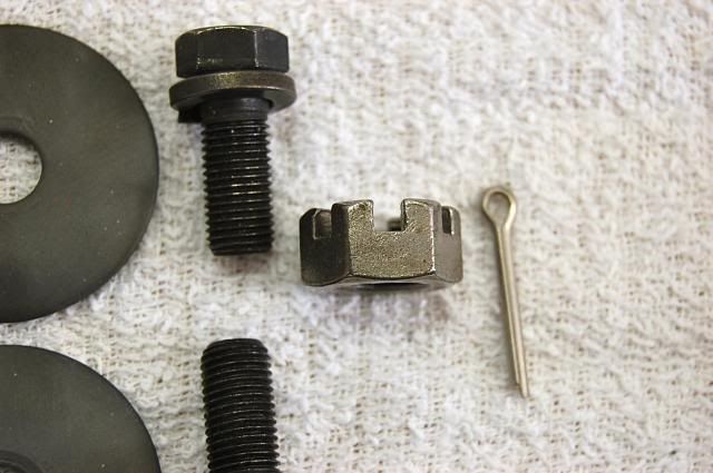

    For 'black' finished fasteners I use black oxide dip. This process you can do at home too.
    Here's a couple of pictures.
    Here you can see a black oxide bolt and washer next to a manganese phosphate retainer.
