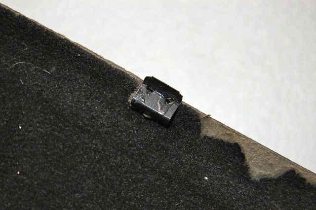

          Hi Sheldon,
          On my car the glove box liner is held in place by 2 small barbed spring clips. One on each of the long sides.
          The clip pushes up into the plastic compartment frame.
          I don't think the clips are shown on the sheet I'd expect them to be…. UPC1asm, Sheet E8.
