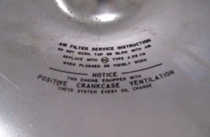

    Hi Gang, is the below air cleaner lid silkscreen correct for a 1970 LT1 Corvette dated June/70?
    Thank you,
    Dan

    No, that is a 1969 style. Later 1969 (say after September 1969) and all of 1970 to 1972 will have straight lined silk screened instructions. I believe the wording is slightly different as well. This applies to open element air cleaner lids, and NOT closed element.

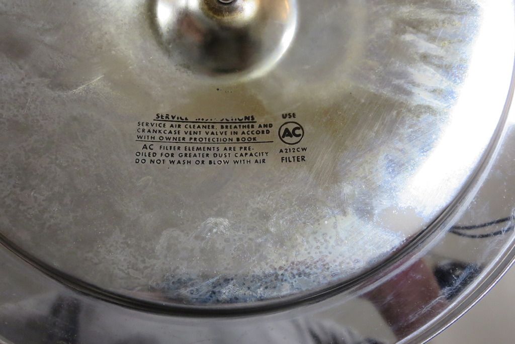

      Re: 1970 LT1 Air Cleaner Lid Silk Screen
      1970 open element air cleaner lid.
