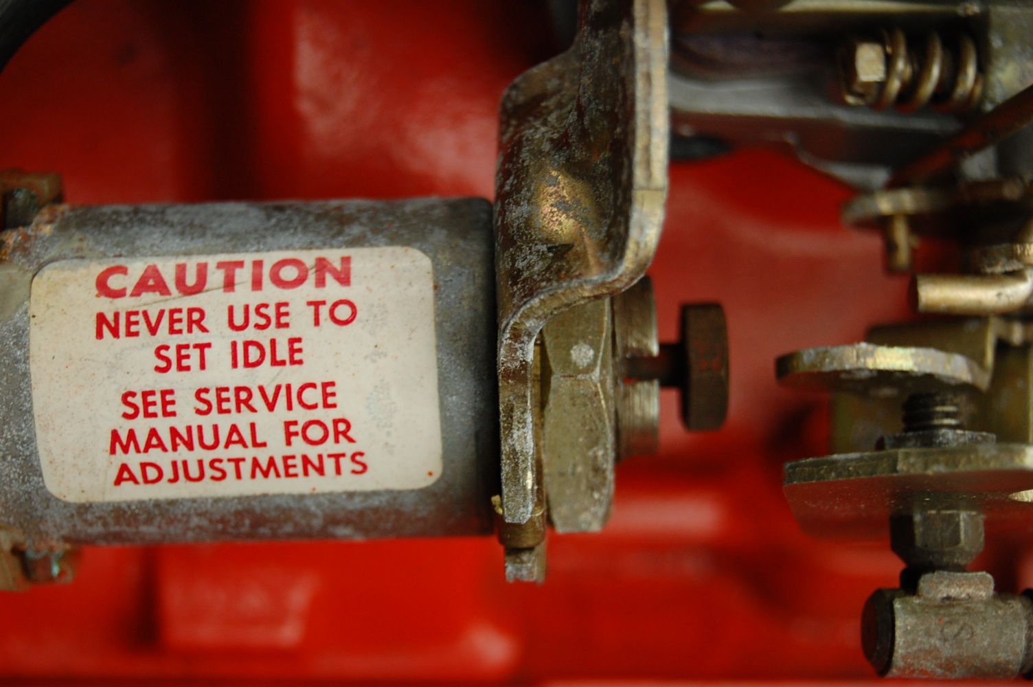

    Does anyone know what the finish should be on the bracket that attaches the CEC solenoid to a holly carb on a 71 car? And also what the finish should be on the nut that attached the solenoid to the bracket? Natural? Dichromate? Other?

    Perhaps zinc plated with a dichromate wash on both the bracket and nut.
    My observation is that the threaded portion of the body of the solenoid has the dichromate wash too.

      Re: 1971 CEC solenoid bracket
      For what its worth my base motor car with a Rochester has the same finish as Alan's except my plunger is dichromate. My label is not visible from that angle, but I think Alan's is more representative.

        Hi Bill,
        I think you're right about the finish on the plunger.
        One of the solenoids I have that came from a Chevy parts department also has the sticker in a position that it can't be seen when the solenoid and it's bracket are mounted to the carb.

          I think your bracket is on a Rochester carb, is this correct? I believe the bracket is configured differently for a Holly. Can anyone confirm that the finish for a Holly is also dichromate? Thanks.

            Hi Stan,
            You're right.
            I missed the fact that you were asking about an engine with a Holley carb.
            Sorry!
            My bet is that the bracket and nut for that application have the same finish.
              Yes a gold dichromate finish on bracket, nut, bolts and french lock. Have seen a black nut finish but think that it is a service replacement. Have not seen one on a original car.
                Agreed. Gold dichromate for the bracket, nut and the securing tab. I have NOS ones around here somewhere, and they're gold just like the originals I own.
