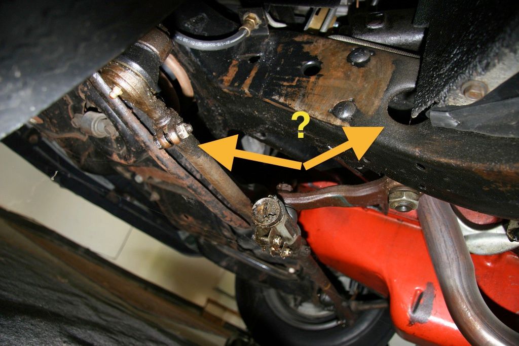

            IMG_4233 by Patrick Hulst, on Flickr
            Here is one of the very last 1972s, and at the time of the photo had 6500 miles on it, one owner.
            Natural?

              Re: 68-72 Tie Rod, tube, and clamp finish
              Natural?
              Looks like remnants of something on the sleeve. Grease or cheap asphalt paint?

                • 15637
                Bill
                Cheap asphalt paint is my call, but that is just my 2 cents. There are other people you will have to please.
                  • 11698
                  IMG_4080 by Patrick Hulst, on Flickr
                  Now here's one of the same tie rod from the front.
                    • 3422
                    Hi,
                    To my eye it appears the camera thought it was seeing a very similar surface in both places.
                    • Bill L.
                      • February 1, 2004
                      • 1403
                      Hi,
                      I completely agree Alan. The question is this asphalt paint or frame type paint that has bubbled a tiny bit due some weathering or exposure to some type of fluid.

                        • 11698
                        Frame is missing paint I believe due to leaky master cylinder, which was one of the 3 items (MC, battery, exhaust) replaced in the last 40+ years. I have some other photos at home and will try and see if I can post those later.
