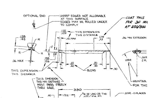

                        • 43246
                        Re: '72 steering column hazard switch rod
                        Originally posted by Nick Kammer (33307)
                        I had thought of that and after disassembling the column there is no sign of it. I do have a box of loose parts that came with the car...I'll check that to see if it may be there otherwise the search goes on. I'll just button it up and live without a working hazard flasher. Larger problems I've had. Thanks to all for input.
                        Nick-------
                        Here's what it looks like (with installed knob):

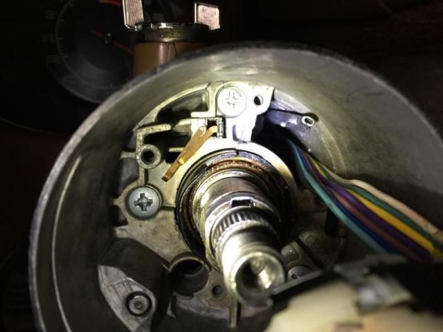

                        • Jim S.
                          • August 31, 2001
                          • 730
                          Here is a picture of the hazard switch lever in place (roughly at the 1 o'clock position). You can see the end that plugs into the bottom of the T&T turn signal switch. Please note that this picture is rotated about 90 degrees CCW. So the lever would normally be at the 4 o'clock position as the T&T column is installed in the car.
                          The lever looks like this and is just about 4 inches long.
                          Jim
                          • Nick K.
                            • December 1, 1999
                            • 75
                            Jim...thanks for the pic. that is a big help. I did find the lever in a box of loose parts. The tip of the lever seen in the pic looks straight in your pic. The tip of the lever that I found has approx a 30 degree bend in it. Is it supposed to be straight as it seems to appear in your pic?

                            • Jim S.
                              • August 31, 2001
                              • 730
                              Nick, this side view does show a very minor 5 degree bend at the turn signal switch end. Definately not 30 degrees.
