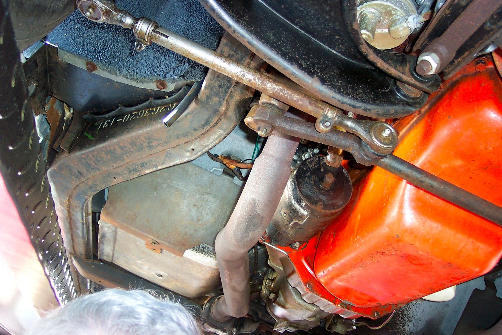

              Here's a picture from a very low milage 72 but I'd think it would be typical of what was on your 70 also.
              As Joe said, not much paint was on the top of the cover where it tucks up behind the rear of the oil pan.

                To clarify, I was referring to the automatic trans inspection cover, following the direction Mark led.
                Yes, the 4 speed one was supplied in steel and painted orange as mentioned elsewhere. Alan shows a very nice photo.
                Sorry for any confusion.
                  Another great picture Alan!
