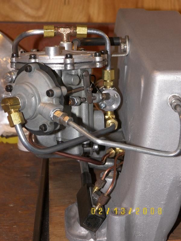

            I purchased a Holley NOS powershot solenoid fuel valve (nitrous). I could not find Parker solenoid.
            As a substitute for an original CSV, a solenoid valve is a good option. You've got to do some plumbing to make a neat install. The following picture is how I install solenoid valves on '62 units when the owners don't care about preserving an original appearance:

            Taking nothing away from the quality of Frank's work, I've found the electric valves to be more reliable. Since I don't have my fuelies judged, I value reliability over original appearance.
