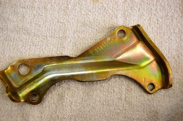

      Hi Dave,
      Are you asking about your 72?
      If so, I believe Edward's right.
      This bracket was just out of the bath for a day or so. The brightness tones down as time goes by.
