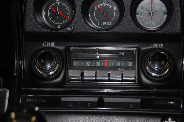

              The reproduction bezel does have at least one other 'tell' that I'm aware of…. the lettering of the word TUNING runs slightly up-hill from left to right.
              Once you've seen the two together it's quite easy to spot…. but I'm not sure if it's enough of an issue for a deduction of any points. I like to look just to see if the bezel appears to be an original since so many of them have been broken over the years it's nice to see a car with an original.
              Added: I just saw your last post about your broken bezel; is it broken on one side or two?
              Here's an example of how straight/level the lettering is on an original.
