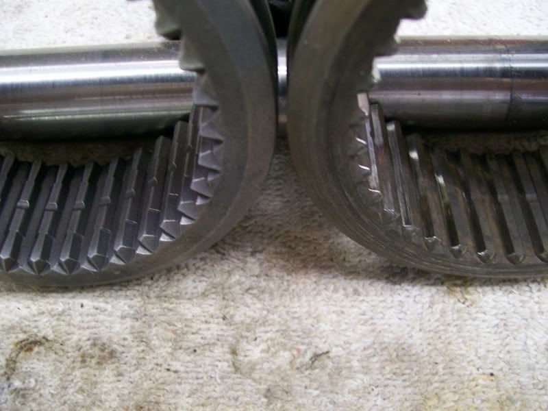

                For a Muncie------------NOT, repeat, NOT a T-10, the addition of a (pinion) shim (.030-.032) is good to do during a rebuild. IT IS NOT, repeat, NOT A FACTORY PART FOR A MUNCIE!!!! Nor, is it a "hotrod" modification. By installing a shim (in addition to the oil slinger) BETWEEN the front bearing and the input gear, the input is moved deeper into the 3-4 synchronizer, thus assuring a somewhat more secure engagement. Most, if not all, of the transmission rebuilding suppliers for Muncies include the shim in their rebuild kits, and recommend installing it between the front bearing and the input gear. I have followed this recommendation for the 40+yrs that I've been rebuilding 4spds (mostly Muncies) and there have NEVER been any issues arise. NONE! Also, on MOST Muncies and T-10s that I rebuild, I also replace the stock synchro sliders with Torkloc sliders. The additional machined back cut in the splines of the slider help to keep the slider pulled tighter into the engagement teeth of each gear, which greatly reduces the possibility of the tranny popping out of gear. This is an especially good upgrade for trannys which have worn engagement teeth.
                Below is a comparison of a Torkloc slider (left) and a stock slider. The additional machined back cut in the splines of the Torkloc slider can be seen clearly.
                DO NOT, DO NOT, DO NOT add a shim between the front bearing and the input gear on a T-10!!!!! DON'T DO IT!
                If a shim is added to a T-10, it causes the input shaft to apply pressure to the main shaft which USUALLY will cause shifting problems, PARTICULARLY 2nd gear! In fact, if a shim is added to a T-10, it may be nearly impossible to shift into 2nd gear.
                As mentioned above, a spacer is installed BETWEEN the front bearing and the front snap ring--------------that's all.

                • Joe R.
                  • July 31, 1976
                  • 4551
                  Re: Muncie rebuild question
                  Tom,
                  I've used the Torkloc sliders on the T-10's and never had a problem.
                  Thanks for the great advise and experience.
