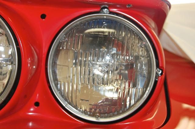

          You have it right, more or less. There are also running changes to the headlamp bezels which you didn't mention, but Alan alluded to. If we get into that there are also changes to the location of the lower headlamp washer nozzle, but that is another story for another time.
          I don't have all the change points in my head, but I believe this is covered in gorey detail in the TIM&JG. I don't have that here at work either.

            Hi,
            My mid-January 71 car, (6589), has bezels that have both nozzle holes in the vertical surface between the lights, not the earlier bezel that had the lower nozzle on the horizontal surface below/between the lights.
