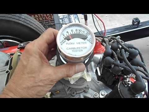

          Friday I re-installed the nozzle after drilling out to 0.025". Ran it up. Much better flow but overall still something wrong.
          I found more issues. As suspected, the secondary carburetors are a additional problem. Their throttle plates are not properly sealing in their bores. I can cause the engine to stall by covering the air horn on the rear carb. I took some airflow measurements to see the problem. Obviously, to me, this is why I still cannot get a good adjustment on the primary carb and why it's running too rich. Under higher RPM's the primary venturis are not atomizing properly. Airflow is being stolen by the secondaries.
          Off they come again. I've been told by the experts that the throttle plates themselves may be defective causing them to not be contacting the bores properly.
          I did a quick clip of my diagnosis.
          More to come. I'm working with my vendor to help him help me and future replacement Holley users. I really don't know why these things end up in my lap but maybe it's just my destiny in life.
          Rich

                  Timothy, No stop screws on the secondary carburetors. Nor emulsion screws. The engine idles down but spec is 750 RPM. IIRC I run out of idle screw adjustment at around 800-850. The Primary(center) carb emulsion screws are set to 1 1/2 turns out, adjusted in 1/4 turn increments leaner(in) with hardly no effect until near the stops. The right side emulsion screw still continued to have little effect on idle. I think I discovered why earlier.....
                  I removed the rear carburetor. This exhibited the high air input at idle as measured using my air flow test gauge. Upon closer examination using a brighter lamp, I see that the throttle plate on the right side was not sealing properly, and the left wasn't ideal as well.
                  Lights off in the shop and used a led lamp into the bore.
                  As shown, light is still showing at the plates to bores, while holding the throttle shaft tight.
                  I disassembled the base from the body. I found a Holley document to verify my procedure which is a guide to replace and adjust new throttle plates. I used it as reference for the process. I filed the edges of the screw tips slightly to allow removal. Using a #1 Phillips bit, I removed the plate screws.
                  After spending over a hour or more trying to get a tighter plate to bore fit, I got it better than it was, but not a perfect seal. The Right plate cannot be sealed tight. The left appears fine. So I swapped the R & L plates and tried again. Similar results. I took some caliper measurements of the bore on the right side and I'm seeing a variation. I'm not sure if it's designed that way or not. I will have to call and check in the morning, and try to discover a tolerance spec for the plates and the bores.

                              Pete, yes absolutely, and that's what I've been fighting with since last night and for quite a while today. I get one set, but the other won't give a tight seal no matter what. I'v been at it for hours already today. I think I've reached then end of any possibility that these will work, as I feel the plates and the bores are the problem, or both. Also, there is so much play in the throttle shafts to the bores that it makes it worse. Original carbs have similar shaft play, but add that to, IMO, defective parts and I think I'm fighting a losing battle.
                              I just finished setting the plates the best I can and will try one more time on the engine.
