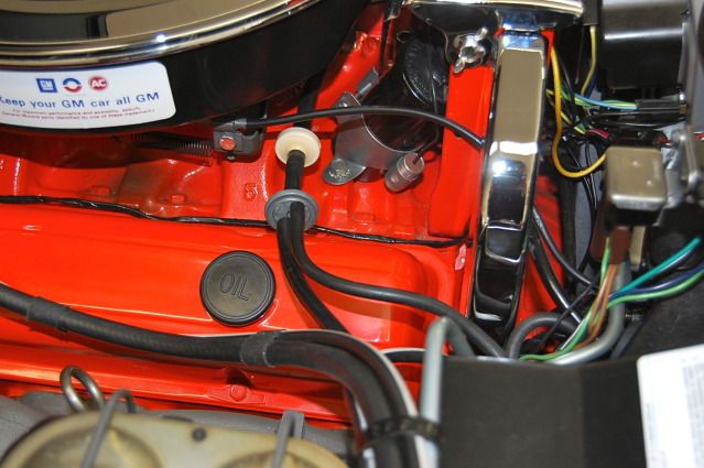

      I think the first part I'd check is the check valve… it's the second of part of the vacuum systems in line at the intake manifold vacuum fitting.
      It should hold vacuum at the side with the single nipple.

        Allen ---- Is it the white thing or the grey thing?
          • 3416
          Re: A common C3 WS wiper door problem?
          Hi Patrick,
          The first item is the white plastic filter, next is the gray metal check valve. It's purpose is to retain the vacuum in the system when the engine is shut off. They are known to leak and/or fail.
          You should be able to suck through the two nipples but not at all through the single nipple. (A VERY technical test!)
          Because the valve also splits the vacuum to both the 'control side' of the system and the 'servo side' of the system a leak can cause a variety of both headlight and wiper door symptoms.
          Look for Jack Humphrey's posts about 'winking headlights' and 'dancing wiper doors'. Good info there!
            Alan you have a really nice clean engine and firewall.
              • 3416
              Hi Jim,
              Thanks very much.
              Some folks find it a bit too pretty!
              I tried to make it look like the workers at St.Louis were all having a really good day.
