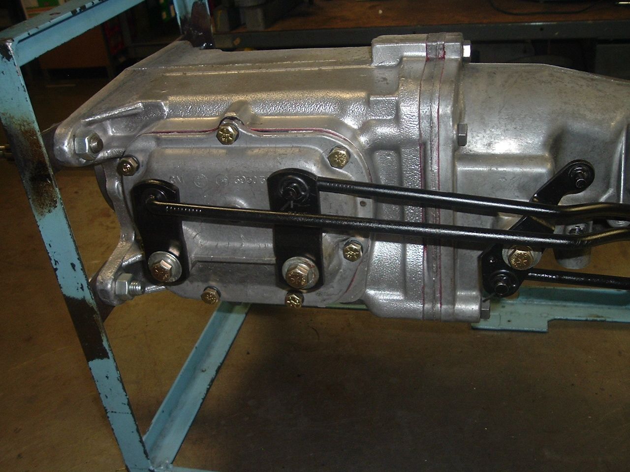

    Which shift lever goes onto the front **** fork, in the cover plate? Is it the 3-4 lever, or the 1-2?

    The forward most shift lever is the 3-4.

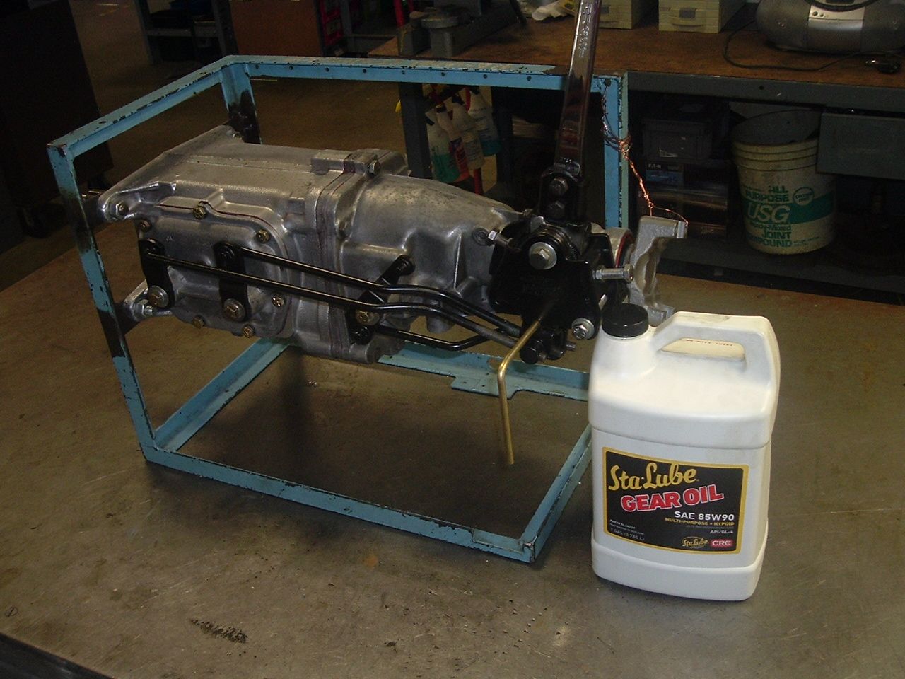

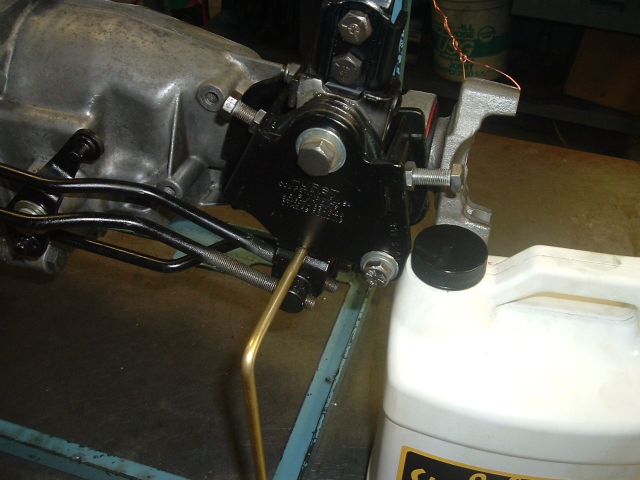

      Maybe this will help. This is a '69 M-20 Muncie with Hurst shifter I just finished.
