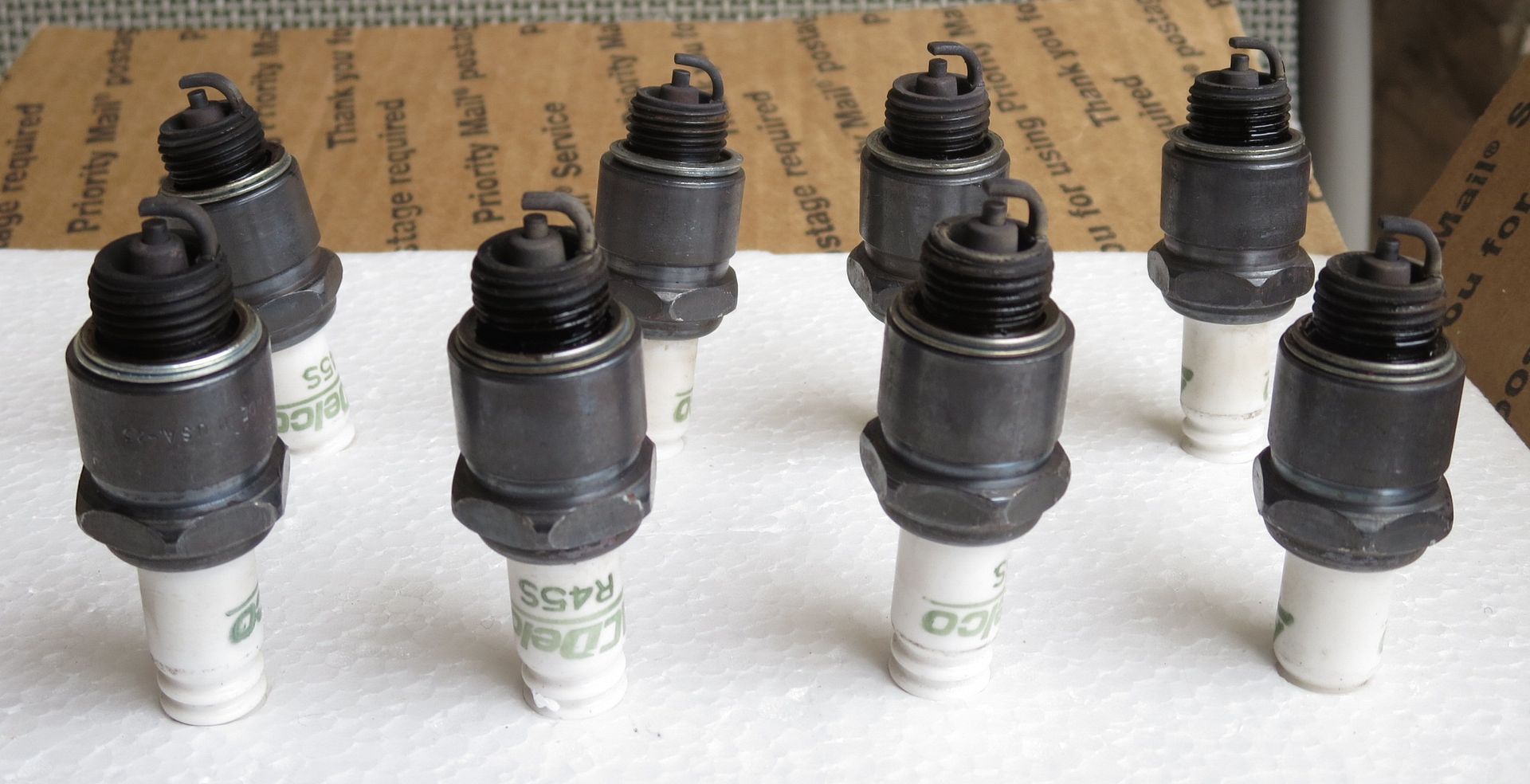

    Todays trouble shooting, engine is cold (as cold as Texas can be), checked resistance on all plug wires. They seemed to be within normal limits ranging from 17k for #1 & 2 and 10k for #7 & 8. Pulled all spark plugs, all looked great, gapped at .035, no difference in any of them.
    Re-installed plugs and wires, pumped the throttle, accelerator pump squirts fuel, crank engine, engine fires and starts running on the accelerator pump fuel charge, vacuum is created, pulls choke open 1/4 inch, then engine dies. I've tried numerous times manipulating the throttle, cannot get engine to run after accelerator pump fuel charge is burned up.

      Mike start with the easy stuff. Check point gap, dwell and timing. The plugs look all carbon up. Are plug wires carbon core stuff or a good wire core? Do you have another coil to try?
      What makes you say not getting any fuel from the idle circuit of the carb? After all you say it idles....?

            EDIT: Yes, the plugs have some carbon but that's expected after the cold start and short drive cycles you went through. They don't look nearly bad enough to cause your problems... IMO.
