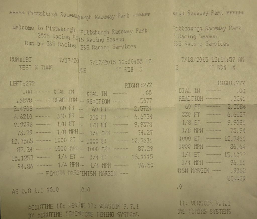

    I took the car to the drag strip tonight and sad to say was a bit disappointed. The car is a 1970 Coupe, L-46, M-21, 3.70:1, with Chapter & Regional Top Flights. I ran the car on the strip with no modifications; it was setup the same way as I use it for daily driving and judging. (Bias-ply tires, TCS operative, etc, etc.)
    The last time that I drag raced was about 20 years ago, so I am familiar with what is “supposed to happen”. Back then I had a 1989 Formula 350 A4 that ran 14:45@97mph and a 1991 Corvette Coupe A4 that ran 13:80@100mph.
    Tonight’s three runs were the first time with a manual 4spd, so my launching and speed shifting is probably nothing to write home about. I have to say that either I or the car is consistently slow. Not sure what went wrong, but the 1970 sure feels stronger than the 1991 I use to have.
    In the first run (15:12@94mph) I had shifted into 4th just before crossing the line. In the second and third runs (15:11@96mph/15:10@96mph) I left the car in 3rd , crossing the line at 6000rpm +/-.

    Reaction time at the tree.
    Needs to get close to a double zero or better.
    The 60' times are to slow.
    I was always told that the first 60' make a huge difference in the overall 1/4 et

      Mike - With a final speed in the mid 90's I would have expected an ET more in the mid 14's. What rpm do you launch at and did you notice a lot of tire spin? You know if it's been a while since you were on the track, it could take a few more runs to get familiar with that car. I had my 66 smallblock Coupe out at Infineon Raceway back in 2008 for the first time since we bought it in '89. Here I was expected to see some decent numbers but with the 215-65 tires I had way too heavy a right foot and spun all through first gear. Still was a lot of fun though.

        Should be running mid 14s. Really good tires and perfect reaction time may get down to the low 14s. You gotta drive it like you hate it to get the best times. You know the old saying. Drive it like you stole it.
        I know I could not beat on my L46 to get the best time so I am just saying Non matching numbers and it would be another story.

          The MPH is good and in line with what a production L-46 could do back in the day, but the ET is low due to the terrible 60' time, which is in line with my 2700 pound, torque-shy, two-liter Cosworth Vega that runs 17-flat at 83 MPH with an easy 2000-rev launch and granny shifting.
          Getting a good ET is all about the launch, which is a function of traction and driver technique, and it takes a lot of practice to get it dialed in. The MPH number is indicative of average power. A lot of guys launch too aggressively and get too much wheelspin. The best launch just "hazes" the tires and is actually easier on the drivetrain.
          Your reaction time is commendably good. I fact I think the 0.3241 would get a red light at some strips since it's less than 0.500.
          If you haven't optimized the WOT spark advance map it could be better, so a sub 15 ET and another couple of MPH is certainly within reach.
          If you want to get to the line quicker than the guy next to you, stage deep. If you want the best ET and MPH stage shallow, and I think with a little practice you can get the 60' time down to below 2.3, which will get you into the 14s.

            "Really good tires and perfect reaction time may get down to the low 14s."
            Reaction time has nothing to do with ET. It's just the time from the green light to when the front tires break the light that starts the ET clock.
            Take a guy in the left lane that has a 0.6 reaction time with a 14.5 ET. The right lane guy turns a 14.4, but has a 0.8 reaction time.
            The left lane is the winner because he crossed the finish line first by 0.1 second.
            The winner is the guy who gets to the finish line first, not the lowest ET, so reaction time is only critical in a heads-up race and is strictly a human factor, totally independent of vehicle performance.

                        As already said, since you own the car you were probably more gentle with the clutch and synchros than what is done to race cars or street cars when tested by magazines.
                        My experience is consistent with yours. I owned a 1973 L82 M20/3:55 a few years ago that was stock except for headers, AIR removed, ignition re-curved, no TCS, and its original Q-Jet tuned for the street. It ran a best of 14.9 @ 95mph with me being gentle during launch and shifts. The L82 is basically a low compression version of your engine.
                        What does surprise me is your L98 Vette running 13:80@100mph. I had a 1987, 240HP L98 automatic that ran a consistent 15.0 @ 90mph. Your performance is closer to '92-'96 LT1 territory.
                        Separate data point: In the mid-70s I had a stock 1969 GTO 400/366HP RAIII with M20, AC. I'm guessing it had gears in the 3.23 - 3.55 range. Its best was also 15.0 @ 90mph while driving conservatively with street tires. I remember trying several runs to break into the 14s with no luck.
                        I never thought before how closely matched these three cars (L82, L98, RAIII) were.

                          If you Google "1970 Corvette Road Test" you'll find some vintage magazine articles showing:
                          - 1970 LT1 with 4:11 gears: 14.36 ET @ 101 mph (Motor Trend)
                          - 1970 LS5 Auto with 3.08 gears: 15.0 ET @ 93 mph (R&T)
                          So in comparison your L-46 is doing fine.
