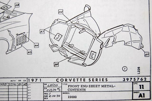

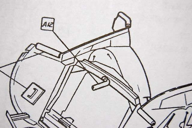

    Hi Mark,
    Take a look at UPC 11, Sheet A1, Item A12. (1971 AIM)
    It shows a support rod running to the TOP of the core support.
    Is it possible that a/c cars had 2 support rods?
    It's not shown on either the radiator or a/c sheets?!?
    Maybe miss-drawn?

        Re: Need help identifying a support rod for the radiator/core support
        Hi Mark,
        The AIM as it sometimes is proves to be a bit of a tease. (This is why each AIM should come with a rubber mallet so the user can beat it against his head on occasion.)
        The brace appears in that drawing but not anywhere else in the manual that I can see! Note the part of the brace shown is configured like the lower brace you already have in place!
        That's why I said it may be just a drawing with an error.
        Is there a hole in your core support in about that location? The threaded end of the brace could pass through it.
              Thanks Alan and Terry.
              Yes, there is a threaded hole in the top of the core support where AIM shows one end of the A12 support rod. I held the rod to that hole in a variety of positions, but it's not apparent where the other end would go (the possibilities are limited since the hood needs clearance to open and the AC condenser creates some interference). The rod in the drawing looks like it has almost a 90 deg bend at the end, while my rod is bent about 45 degrees.
