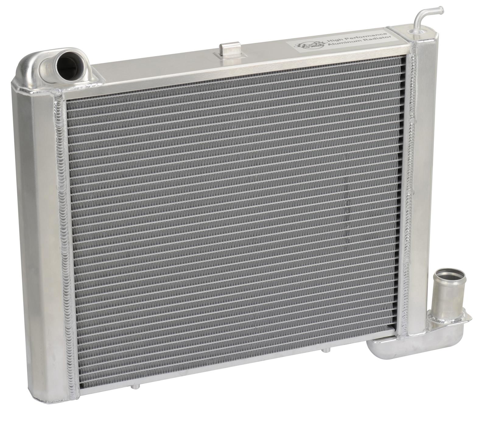

                      Dewitt has another radiator option at a lower price:
                      I have this Dewitt unit along with air and just got back from road tour over 4 thousand miles. The 107 degrees in Kansas was a bit warm on the 65 with 327 but did not go past the 3/4 mark on the temp gauge. Running at legal speeds in over drive with the air on was taxing on the car at 107 degrees but cycling air on and off got us thru it. Normal air temperatures were not an issue at all. I would not attempt a trip with temperatures in the 90's to 100's again if at all possible. Maybe a 7 blade fan would help some. But my 5 blade fan is fine for NORMAL temperature cruising.
