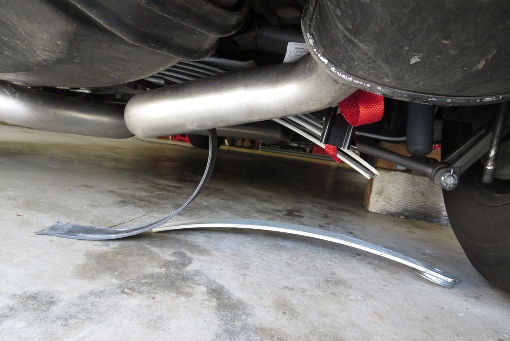

    How long is spring life??? Exactly 103,471 miles.

      That must have scared the crap out of both of you. I've never seen that before. Appears y'all and the car are none the worse for the wear. Hello, Eaton, you're not going to believe what happened...

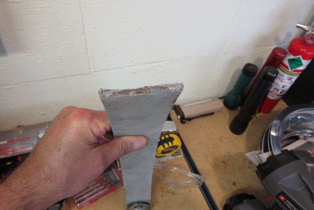

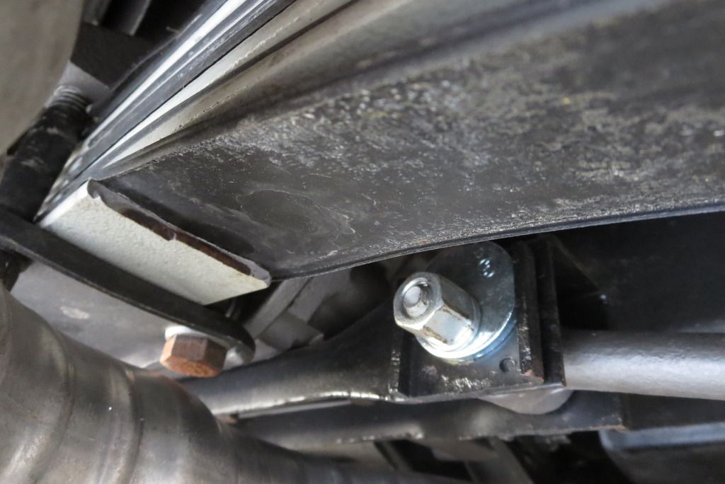

        That spring looks relatively new or recently rebuilt. What's its history?
        OE springs rarely fail unless they are overloaded (tough to do on a Corvette) or suffer from severe corrosion, which doesn't appear to be the case from the photos.
        It's also possible that a surface flaw created a fatigue crack that propogated and eventually caused a fatigue failure. Most fatigue failures start from such a flaw, and they can also start from a corrosion crater. Cracks can be revealed by Magnaflux inspection, and those that might be undetectable can be stopped in their tracks by shot peening the surface, which work hardens the surface and makes it stronger and more resistant to developing cranks from microscopic surface flaws.
        It's probably a good idea to have the leaves Magnafluxed when it's time to rebuild, and shot peening should increase durability, but it might be detectable during judging.
        Fatigue failures can often be recognized by viewing the factured area. The area where the crack propogated is often smooth - almost polished, with the final fracture area rough surfaced.
        From the photos, it looks like the sides are smooth, indicating two cracks one propagating from each side, or it could have started from the top surface and worked it's way around the sides.
        If you can find a good, serviceable main leaf, just replace it. The rest of the leaves are probably okay.

            Not sure of it's history. It's been that way since I bought the car four years ago.
            Two days before I had driven it to work and was scheduled to make some dynojet runs that very morning, but thankfully the dyno shop called and had to cancel. Last September I drove it 1100 miles for the New England Regional. Fortunately it happened close to home.
            Unfortunately the edges of springs 2 & 3 (from the bottom) were ground down during my "look at all of the sparks" show. We ended up doing some quick roadside repairs, cutting off a couple of inches of the already damaged springs and drove it home.

                  From what I can see, I think this spring's failure was entirely due to corrosion damage. This is, by far, the most common cause of leaf spring failure.
