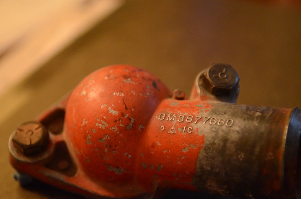

    I'm looking for an OEM or NOS housing to replace a reproduction on my '69 427/390. I've got the part number but I'm wondering if the housings were date coded. I'd appreciate any information. Thanks!

    I don't think that any of the original GM #3877660 thermostat housings had any sort of date code. Some of the later SERVICE examples have some embossments that some might regard as a date code but I do not think they are such.

              One word of caution: many judges consider that all big blocks had the part number of the thermostat housing on the flange rather than the neck. I don't believe that. It may well be that many or, even, most big blocks used a thermostat housing with the part number on the flange but I really don't think that ALL were that way. In any event, to be "safe" from what I believe is a misconception, you might want to find a 3877660 with the part number on the flange. The problem is that because of this big block-related misconception, these housings usually sell for much more money. Nevertheless, if yo look for awhile, you should be able to find one at a reasonable price. These things are anything but rare.
                Re: 1969 427 thermostat housing question
                The GM drawing for the 660 thermostat housing leaves the choice of the part number location to the supplier/manufacturer; they could put the number anywhere they liked as long as it could be inspected.
                  Hi John,
                  Do you have a copy of that drawing that you are willing to share? It has seemed (and I have absolutely no scientific evidence to back this up) that the part number location varied based off of casting date rather than big block vs. small block?
                    Hi, Peter -
                    See 660 drawing below, with notation at the bottom for "optional" location of manufacturer's ID. The manufacturer of the 660 housing had no clue what the final application would be - he just shipped "X" number to each engine plant. If you need a much higher resolution drawing, I can supply it.
                      [ATTACH=CONFIG]60424[/ATTACH]
                      Thanks John! Another question for you and/or Joe: Who creates/designs the part? Is that a GM drawing which gets sent out to a fabricator?
                      Lastly, I assume the triangle with the "ADC" is the manufacturer's mark. Were there multiple manufacturer's because I have seen housings without (at least to my inspection) any manufacturer's mark.
                        Peter-------
                        A part and drawing like this one was designed and drawn by GM. The parts manufacturer had to manufacture a part which conformed to the drawing and specs.
                        There were almost certainly at least two manufacturers of this part. Most GM part drawings require that a manufacturer's ID appear on the part. However, I've seen quite a few parts over the years that didn't appear to have a manufacturer's ID on them. Usually, I think that parts manufactured by internal GM parts manufacturing operations of the day didn't either require or receive manufacturer's ID. But, I've seen parts that I highly doubt were manufactured by internal GM operations that did not have manufacturer;s ID's on them.
