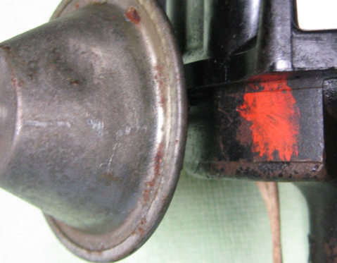

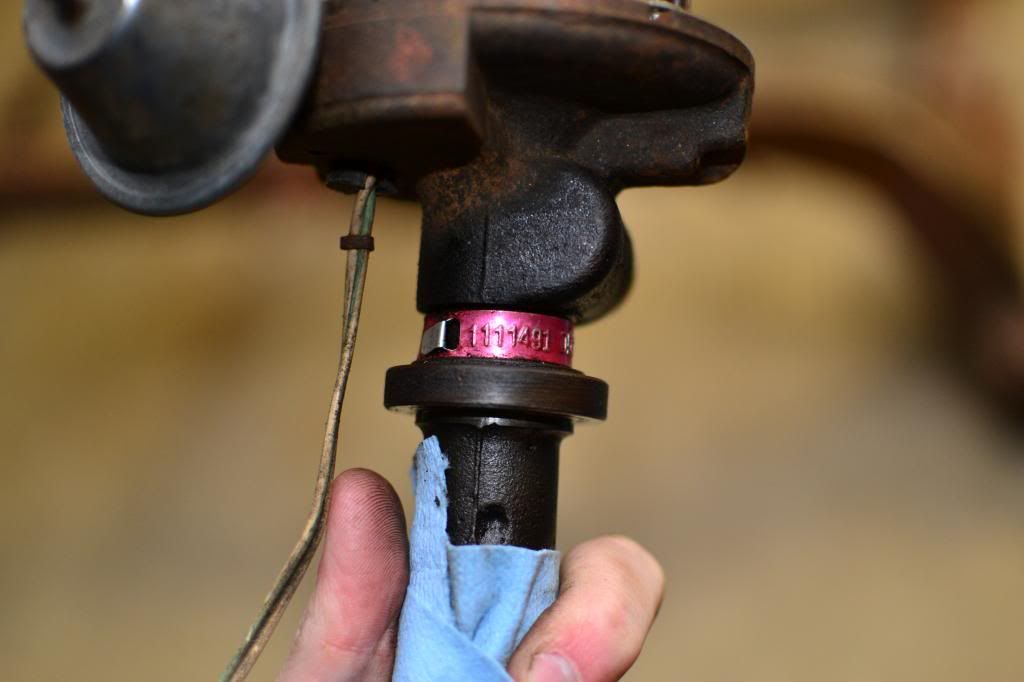

        The aluminum tag should be clean and there should be no overspray on the body. The orange "dot" is on the body of the distributor next to the vacuum advance. Here is a picture where you can faintly see the orange splotch, you'd most likely cast it off as maybe surface rust.
        Here is a picture of one on ebay as well.
