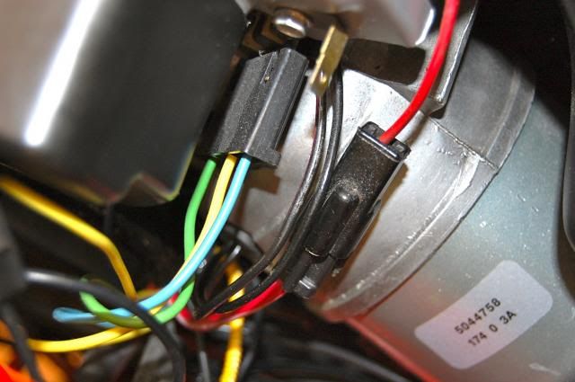

    After I discovered I did not have the correct wiper motor for my 69 I purchased a correct one but I have a wiring question. The AIM shows a black ground wire going from the wiper motor to the heater blower motor but there is no terminal on the wiper motor to attach this wire. Do I need to connect it to one of the screws on the motor case? Thanks for your help.

    Hi Tom,
    Perhaps this one?
