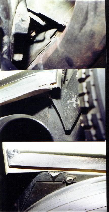

            Looking at the 67 judging guide the tab is the only thing they list being cut on the front 1/4 panel. Attached is a picture of the cut on my car.
            John
              [ATTACH=CONFIG]59420[/ATTACH]
              John
              John, Thanks very much for the time/effort you spent on this. Great info. Wow, looks like they weren't too particular about how they cut the tabs off, huh? - looks about as good/better left alone. Thanks again,
              Rick.

                It may very well be a side pipe car because of the things you list, but the front fenders are not typical of the factory treatment. Could be that it has had new fenders installed.
                This is typical. Known original.
