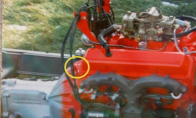

            Hi again,
            That 30897 CA part appears to be what I would expect to see on your sb.
            I found a picture that barely shows the installation.
            Note the tab faces forward. If you try to put the bracket on backward the shape of the bracket causes it to interfere with the bell housing before the bolt is fully inserted.
