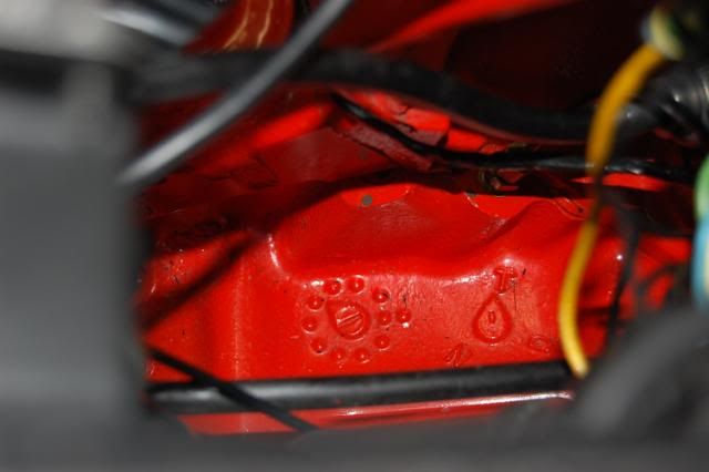

    My 283Cu.In. engine has the same casting date along with the same date code stamped into the engine pad.
    Can these engines be casted early in the day, and then be assembled later in that same day? (Having the same date codes .)
