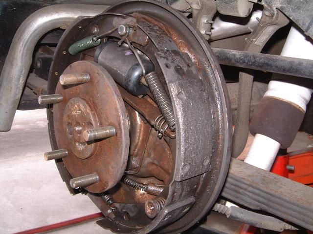

    Robert - My 61 has discs up front and I eventually added self-adjusters to the rear brakes but I do have a couple old pics of the rear brakes with the original style springs and from the looks of it, I'd say the two springs are identical.

      I appreciate the pictures too.
      I took pictures of the brakes before i pulled this apart, and I guess finding one longer spring got me wondering.
