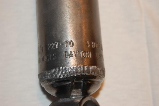

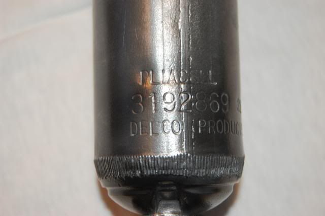

    Hi Mike,
    Welcome!

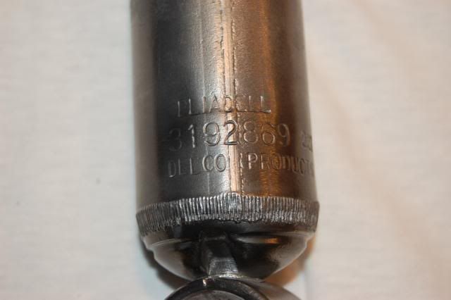

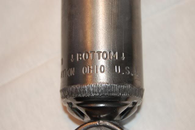

    I'll start with a rear shock.
    Here's a picture showing the position of the broadcast code sticker on the rear shock and some pictures of the information stamped on the shock.
    The shock is from a mid-January, 1971 built car, std. suspension..
    Here's the broadcast code sticker location. I don't know how typical this placement was.
    The date 227th day of 1970.

      Thanks so very much. That's just what I needed for the rear shocks.. I take it that 3192869 is the part #? Do you have similar info for the front shocks? Forum is pretty cool. Thanks again, Mike.

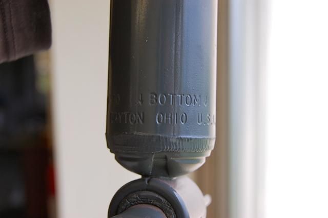

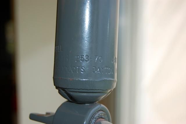

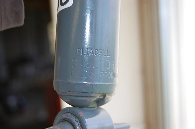

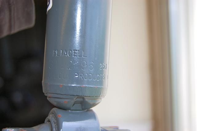

        Also, if the day of the year on the shocks is <100, e.g., 26, would 026 be stamped, or just 26? Thanks again for the help for a rookie. :-)

          Hi Mike,
          I believe that Julian dating typically were 3 digits for the day. For example the date on the q-jet carburetor for this mid-January1971 built car is 0071. 2 zeros as place keepers.
          Here are the pictures of the front shock absorber.
