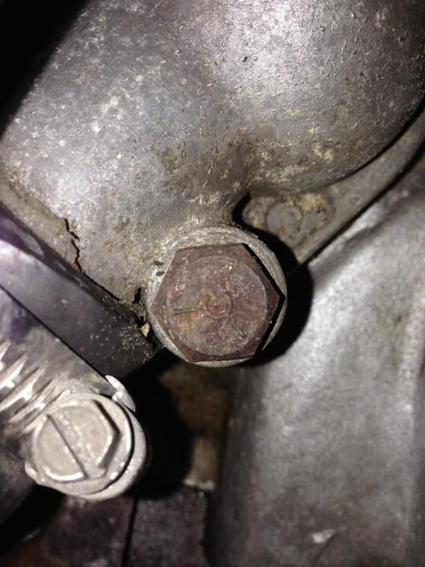

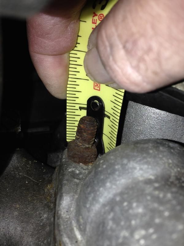

    • Kevin G.
      • February 1, 2005
      • 1076
      Re: Thermostat housing bolt head marking
      Ken
      Here are two pictures from my 72. Hope it helps?
        Kevin, thanks for the pictures. They help a lot. It appears that the bolt and stud that I'm looking at are correct for the application. I'm wondering, though, whether the bolt head marking was the same for the '70 as for the '72. The bolt heads I'm looking at are "TR", "M' and "RSC" bolts. If the bolt head configuration isn't judged then it doesn't matter, but if it is judged, I'm sure that one of the judges will probably chime in at some point.

            Ken------
            The short "bolt" is actually a flanged stud.
            The long bolt was trimmed (i.e. non-indented head) bolt of SAE grade 5 (3 radial lines). The one pictured with a "C" headmarking is quite common. However, many others were probably used. This was a VERY common size bolt, was probably used by the MILLIONS during the period, and undoubtedly had several suppliers. "M" is another widely seen headmark for this bolt. I'm sure "TR" and "RSC" are other possibilities. I think any period-correct headmarking should judge OK. So how do you know what bolt was originally supplied on your engine? The only way to know, for sure, is to have the known-orignal bolt.
                            Did not see any lengths given, The long bolt is 2" measured from under the head and the short bolt/stud is 1" measured from under the head
