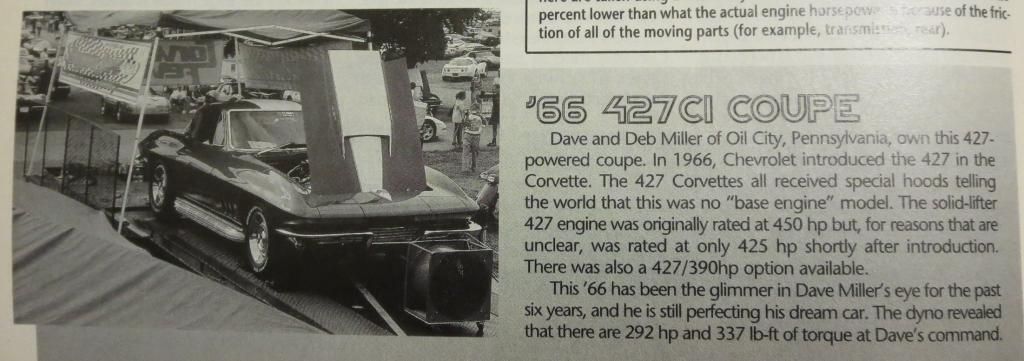

              A little off topic, Corvette Fever, Jan. 2000
              • Steve B.
                • March 1, 2002
                • 1195
                Re: tripower 69 vs 67 intake HP differenece
                That's about right for an L72 with side exhaust, the mufflers were very restrictive. An N11 set up would yield much better results.
