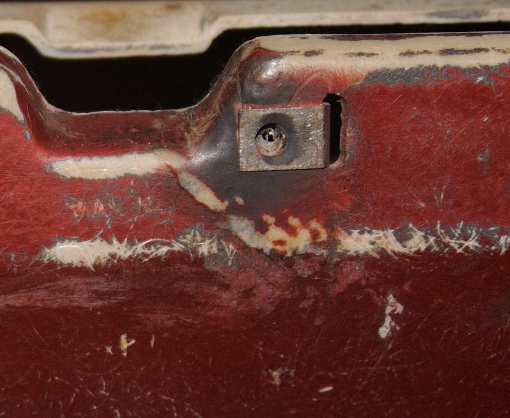

                      • Joe M.
                        • February 1, 2005
                        • 590
                        Re: Screw Hole Repair
                        j-nut hole repair in a 61 door
