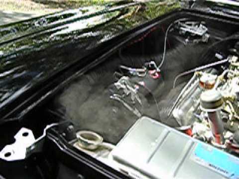

                              I would leave the original block as-is and not rebuild it before I would deck it, and let it keep following the car around. It's the only solid evidence I've got that it's a 340 horse car from St Louis as tachs are easily changed.
                              I can hardly wait to pry the freeze plugs out and see what joy awaits.
                              Steve, I agree that's a good plan. When you do remove the plugs, I think you know what awaits. It will be likely pocketed with years worth of sludge and rusty remnants.
                              I hope you don't mind my slightly off-topic information here, but hopefully good info for you and the masses as we all brainstorm how to avoid issues in our restoration tasks.
                              Originally posted by Steve Garner (60691)
                              At the risk of raising your BP again, your experience was with two ends of a broad spectrum. Certainly the 1st shop was negligent in cleaning, but the "belt sander" deck surfacing is an industry standard. He did not dream up and build that piece of equipoment himself. It is perfectly adequate for 99% of the engines out there. What your shop did is reserved for the other 1% that have an eye on the second digit to the right of the decimal point on their ET cards.
                              There are two issues when looking at the deck. One is flat, the other is square. Flat is measured with a machinist's straight edge laid across the deck and a feeler gauge stuck under it to find any low spots. This is checking for flat.
                              It's quite obvious in your pics that what your shop was doing was checking for square. Square assures that the distance from the centreline of the crank to the deck surface is absolutely even across the entire surface. It then goes on to ensure that the other deck is exactly 90 degrees from the first deck. Then the bores are cut to be exactly 90 degrees to the squared deck. The whole point of this is to bring what was the oe tolerance down to 0. That is totally unnecessary in your kind of build.
                              The "sanding belt" method restores the flatness but follows the original squarness (or off square) that the block left the factory with.
                              In my list I left for the OP I specifically left checking the deck for square out. If the deck is flat why would you remove the stampings simply to improve upon the factory machining.
                              Steve
                              Steve, Firstly, any advice is always welcome. My BP is fine, thanks.
                              I'm absolutely certain you have more experience with these issues than myself, but I have been told that using any type of belt sanding on block decks or heads is not recommended. I'm told it causes radiused edges on all holes, and in the case of coolant port holes can be problematic to get good gasket sealing. My (2nd) trusted machine shop said that they tried that many years ago on heads and it was disastrous. In the case of this engine block that I had the nightmare with, the shop turned the block upside down, hanging from a engine hoist, laid it down on the belt sanding table, which by the way had a belt with small stones about 1/8" diameter and greater, and probably what happened is that the block tilted and moved while the belt was running. To my amazement, I learned all of this long after the engine was back in the car. So you are absolutely correct, he didn't know what he was doing.
                              So yes, the "PROCESS" to use the sander was certainly wrong, and the machine may have been out of tolerance as I was told later, as the end result proved. I'm not entirely certain that even if perfectly fixtured and accurately positioned, that it could emulate the accuracy and tolerances that very expensive, room sized GM broaching machines performed originally. I have no scientific proof, but merely a opinion.
                              After days of diagnosis and testing trying to figure out why I had a volcano on my hands, I spent time with a much more knowledgeable and experienced shop. He then decked the heads, rebuilt them properly and had them waiting for the block to be corrected. As explained, I tried to get the engine owner to get MY new shop fix the block, but the first shop got re-involved......twice again unfortunately.
                              I understand you likely didn't read my entire thread above word for word as it gets a bit overwhelming and boring, but in fact, I was the one using the Surface Gage Block/Dial caliper. We could not get repeatable results using the straightedge and feeler gauge/flashlight method. I was checking for flatness over a condensed area to understand if the deck was within a reasonable range of flatness. As described, it was all over the place, especially the china wall ends. I wasn't looking for Zero tolerance as a result, but in this case it was severely opposite.
                              Rich
