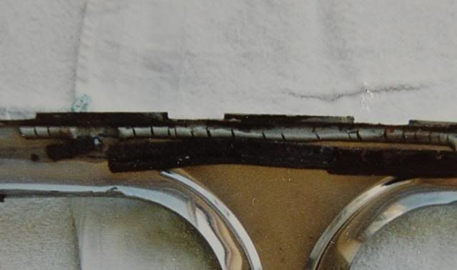

                    This poor picture of the underside of the ss trim piece shows a material similar to black 3M caulk at the flange area of the trim piece that clips over the windshield header, then a semi-hard gray material that I would describe as being similar to old fashion window 'glazing' material, and then a soft black rectangular self adhesive foam strip.
