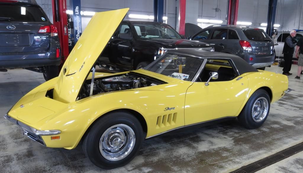

                  Interesting the BJ photos show side exhaust versus the above. If not originally a side exhaust car, why would you add to such an original documented car? It would only hurt value.

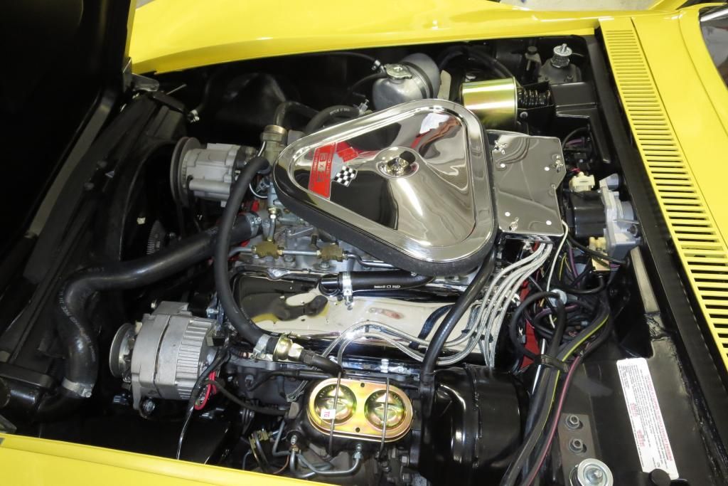

                    Stupid question from me: my 68 L71 has no coolant expansion tank and this 69 does. Was this a change from 68 to 69 or because it's an L89?
                        Rich
                        Rich
                        It was a change from 1968 to 1969. 1968 L71/L89 used the direct fill radiator with no expansion tank, in 1969 they switched to the indirect fill radiator with expansion tank.

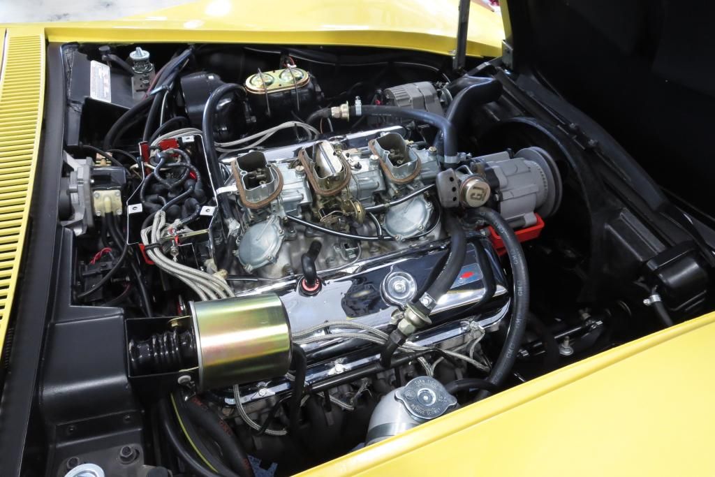

                            Why would side pipes be added to a car that has less than 400 miles? The entire front of the engine has gobs of orange paint applied, again why? Too much under the hood that does not look 45 years old. Such things as the master cylinder cover and wiper canister look fresh as hell. A arm cup washers and bolts has no black? Exhaust manifolds cast sprayed? Not a truthful surviver as too much looks fussed with for 400 miles.
                            • John D.
                              • June 30, 1991
                              • 875
                              Re: 69 L89 At Barrett-jackson
                              To me it looks like a fully restored car...there's no patina in that engine compartment. Definitely not a 350 mile Bowtie candidate.
