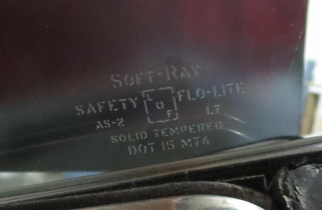

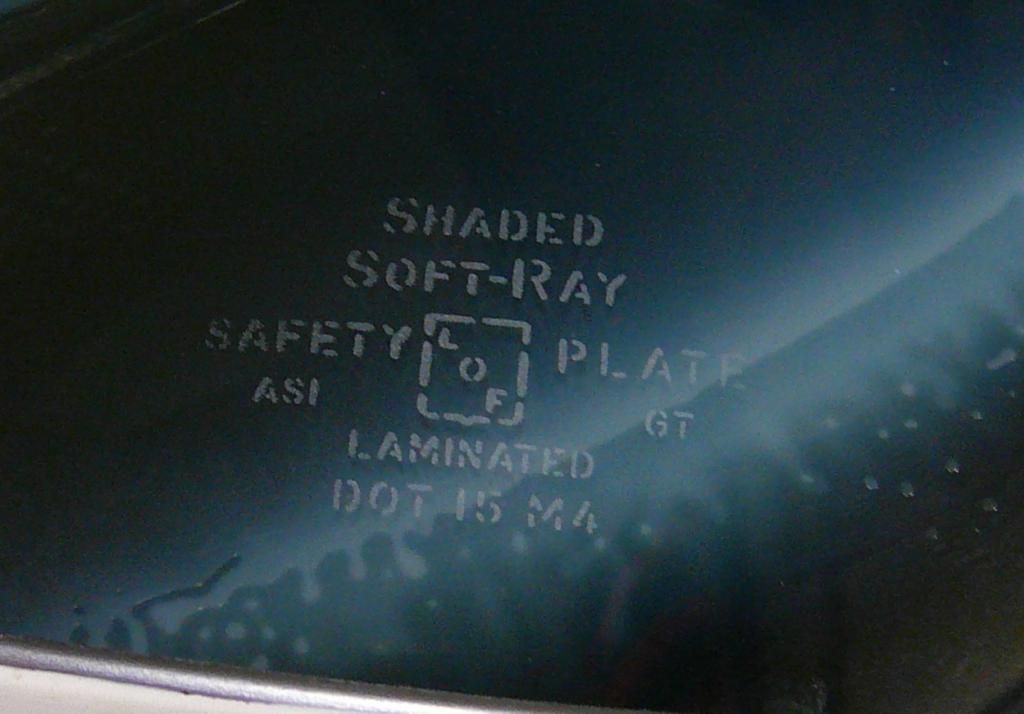

                  • Mike F.
                    • April 25, 2011
                    • 668
                    Re: Correct configuration of windshield logo/date
                    My May 1970 build original windshield is SAFETY PLATE, dated April 70 (GT). Both side windows are SAFETY FLO-LITE, dated March 70 (LT).
                    I believe NCRS judging allows for within 12 months of vehicle build date.
