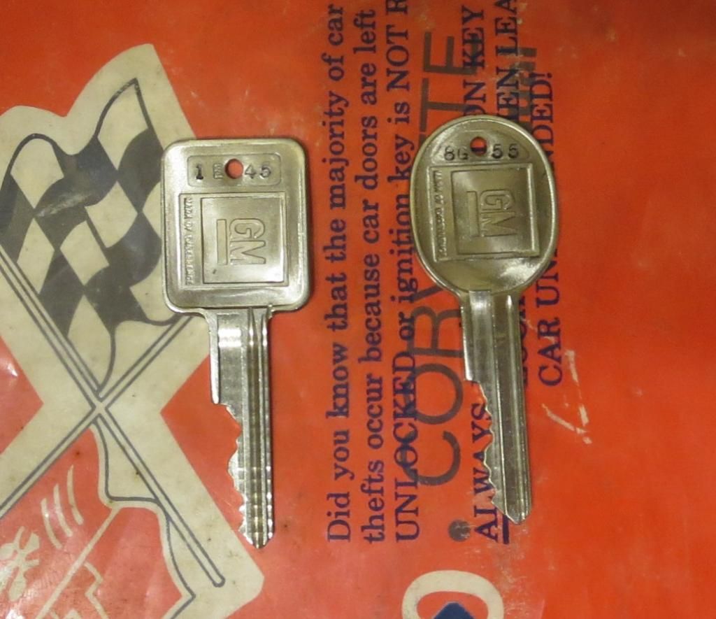

              Here's the old tool again if nobody has ever seen one. If nobody in your area has one, send me your keys and I will gladly punch them and return ! Tom Hendricks c/o BUDS Chevrolet. P.O. Box 128 St. Marys, Ohio 45885 I used to put the key over a 3/8 socket and knock em out with a screwdriver or a punch with a hammer too.

                Just punched one out the "old school" way for old time sake. LOL
