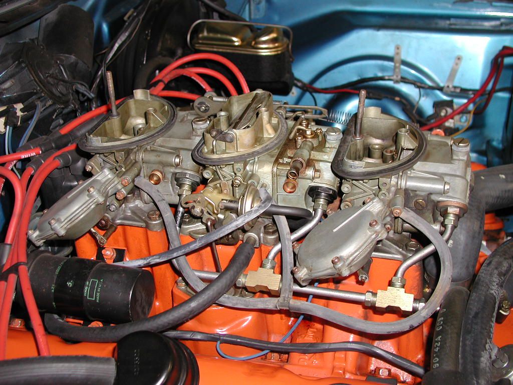

              I have a '70 Challenger T/A 340 6 Pak. Same series carbs as discussed here, 2300C and 2300's. The end carbs do have idle adjustment screws in the baseplates.
              From my Mopar literature...
              "Practically all 340-6 Bbl. setups run in a lean condition. The car will probably not idle well at times and may stall frequently. Unbolt the front and rear carburetors and locate the two soft lead plugs at the extreme front of the base. Remove the plugs so that a screwdriver may be applied to the previously hidden idle adjustment screws. One-eighth of a turn out (counter-clockwise) on these screws should solve this problem."
              "In order to ascertain whether the carburetors are running rich or lean, place the tip of your finger (this pertains to the end carburetors only) on either of the outermost air idle bleed holes. If the engine "falls off" (decreases in rpm), the fuel mixture is too rich; conversely, if the engine seems to "pick-up" and sound stronger, the fuel mixture is too lean."

                        Ron,
                        That's a neat set up and what a maze of plumbing from the emissions era, thanks for posting that picture. The end carbs must have a curb idle discharge port with the adjustment screws plugged. Just curious if the center carburetor has the same adjustment.
                        The "finger the idle air bleed" test mentioned in your post is a good way to test the idle circuit to see if A/F mixture is in the ballpark. You can also do this with a propane bottle and a piece of rubber hose attached to the end. Warm the engine and run it up to approx 2000-2500rpm and slip the hose into a primary venturi then crack the valve to see if the engine speeds or slows as this will tell you if the engine wants more or less fuel. It's also a good way to find a vacuum leak.
