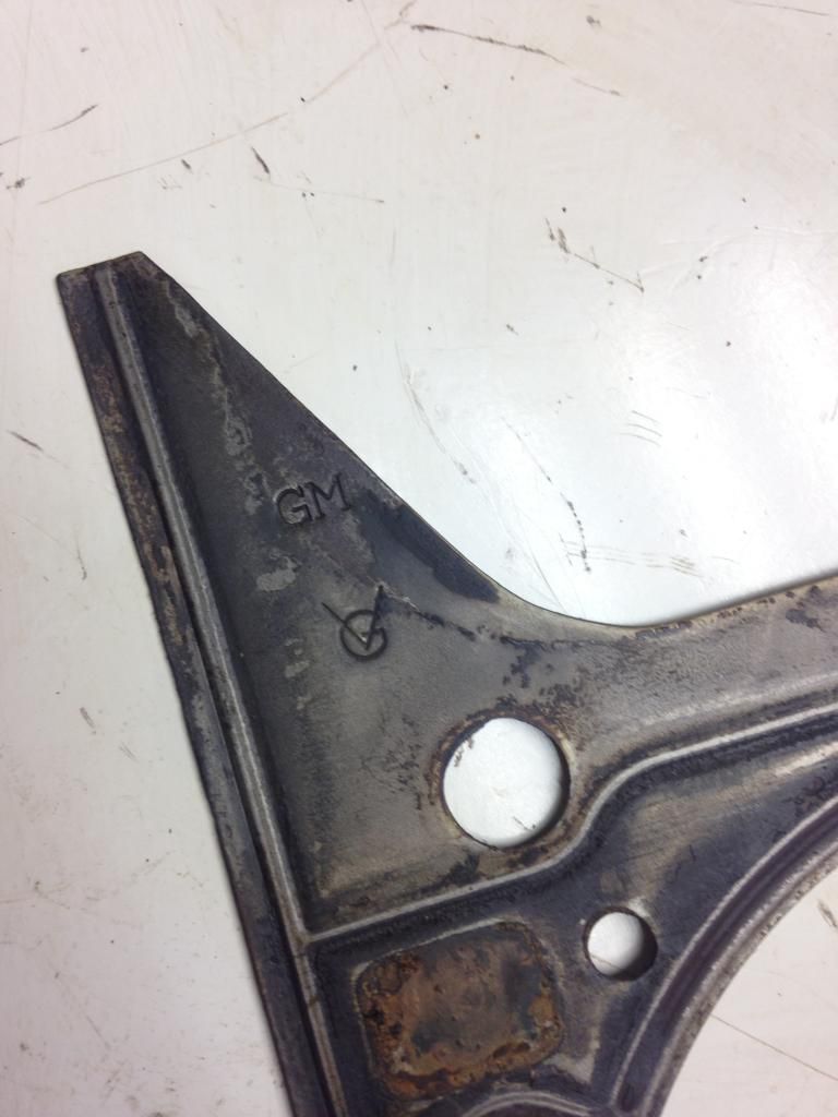

    Thanks for the replies all. I ordered the 962 replacement this afternoon after Duke's strong position. I think that this is a good decision.
    Duke, the only markings I find on the head gasket shim are a "V" stamped over a "G" and "C4". I cannot find anything googling, do these markings mean anything to you?
    Peter

      Peter-----
      The "V over G" embossment denotes Victor Gasket. Victor was a major supplier to GM so it's possible the gasket was as originally installed. However, it's also possible it's aftermarket since Victor has always and still does sell gaskets in the aftermarket. Now they're known as Victor-Reinz, though. I don't know what the C4 signifies. Some sort of manufacturing code, I expect.
        Peter
        Okay, maybe you can take a look sometime again with a magnifying glass. My bet is that there is a small stamped GM part number, but they can be difficult to see on an old gasket. In the meantime, don't throw them away. I may want you to mail them to me.
        I don't think Victor Reinz makes a similar gasket for the aftermarket, today, but I haven't checked for a few years. The thinnest I know of is the Fel Pro polymer coated 1094, which is .015" compressed. It's okay to use if the block deck and head surface check out level. and it doesn't cause the CR to be too high for the configuration.
        Duke

          Duke,
          I spent another 20 minutes looking over the shim. I did give it a good wipe down with some brake cleaner. This did expose a "GM" stamp, but still no part number. Do you have an expectation where on the shim you would find the part number?

            Duke,
            Peter------
            If it's there, at all, it should be on one of the end extensions (i.e. the location where you found the "GM" and "VG" symbols.
            The closest you can come today to this gasket is a Victor-Reinz #1178BS. This is a steel shim gasket of 0.016" thickness. However, I would not use this gasket unless I knew that both the head and block surfaces were perfectly true.

              ...location would most likely be where Joe said. I have gaskets that came off a L-46. They are stamped GM 3830711 in the location where you found the stamped data. This is the service replacement gasket, so the heads had been off that engine. It actually measures .022", but I've seen it speced at .026".
              This gasket is also stamped Mc 6631 on the other extension, so it's a McCord 6631 that they sold in the aftermarket without the GM stamped data.
              I'm surprised you didn't find a GM part number or some other identifying data. That .018" gasket was used by Flint for about 20 years. I don't think there were no other small block gaskets in use in that time period, so I guess they knew that any head gasket at Flint would be the one you have, and it didn't need specific ID data.
              Thanks for spending the time to check it out.
              Duke
