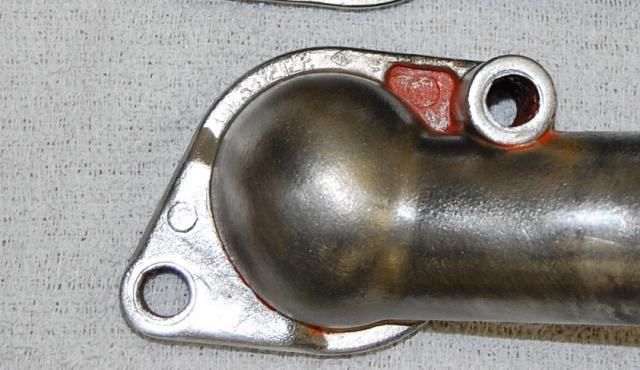

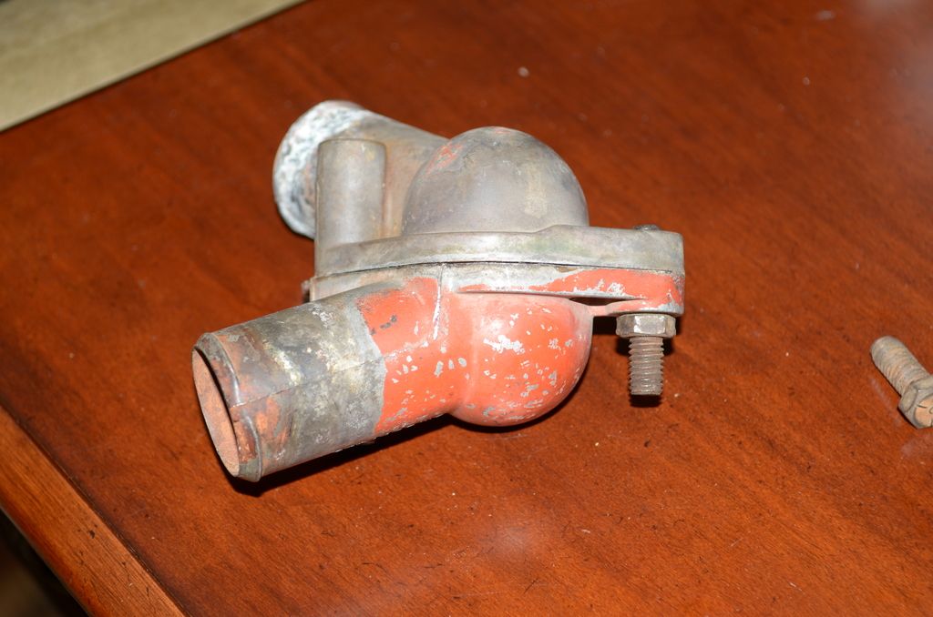

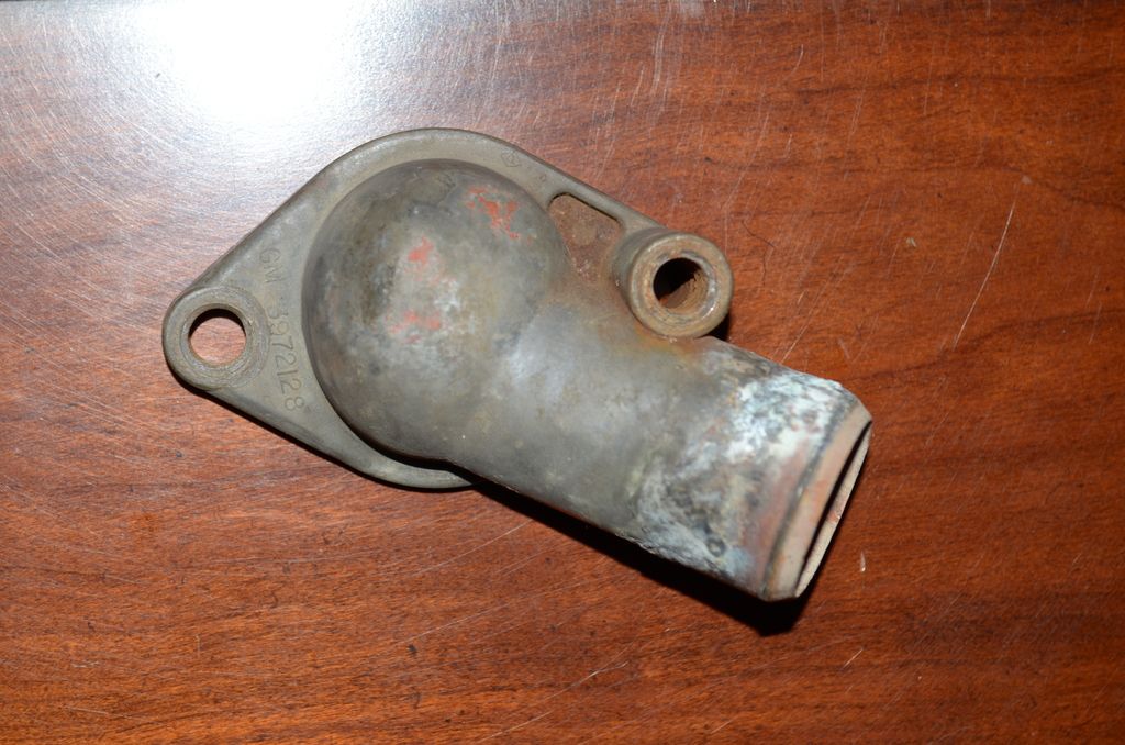

          I have noticed two casting number locations for the 3972128, albeit both are on the base. The first picture is a 128 housing that is a known original off of a '71 base model. The second is a 128 housing that came off of my 1971 L46 CE motor. The third picture shows a thicker flange at the stud location for the 128 than the 660. I have not seen many pictures here on the TDB of the 128, so I thought I would share.
