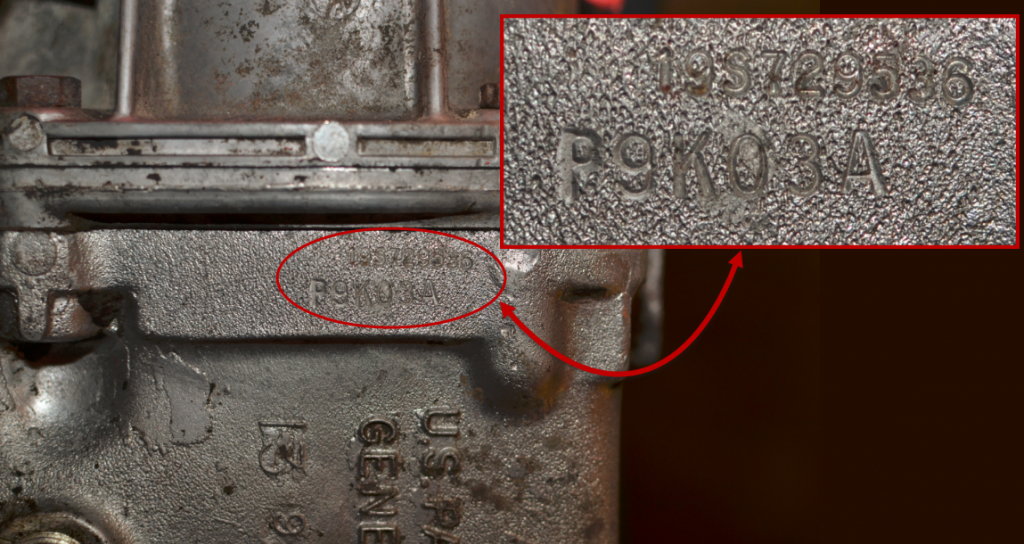

        Are there any other clues as to which transmission originally came in my car? I suspect my car was an automatic changed to a 4 speed.
        Hi Thomas,
        If it was originally a 4-speed, and that transmission is the original transmission, you should find your VIN derivative stamped on the case.
