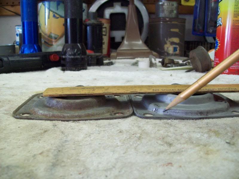

    The first 2 pictures are a comparrison of 55-56 (56 Vette) and 57-64 (57-62 Vette) style axles/axle bearing retainers. The deep retainer is 55-6 ONLY, and the 55-6 axle, bearing and retainer is unique to, and will ONLY fit 55-56 axle housings. You CANNOT interchange 55-6 and 57-64 axles/housings.
    The axle bearing retainers for 57, 58-64 (62 for Vettes)-------------as I have observed--------------are shown below, along with the 55-56 style (57 is center).

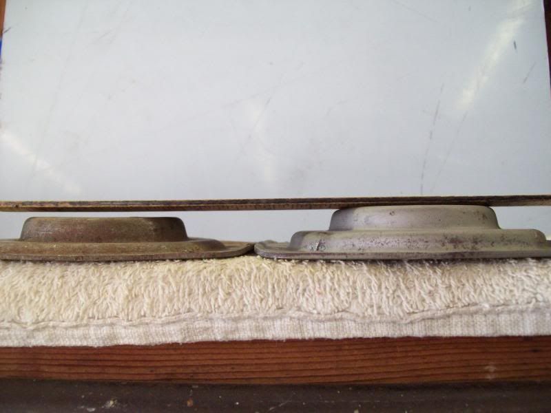

    Here is a comparrison of 57(left) and 58-64 axle bearing retainers. The difference is pointed out with the pencil.
    Now, with all of the above mentioned. Here is what makes the difference, because of the bearings.
    The 55-6 bearing is a smaller diameter than the 57-64 bearing. BUT, the 55-6 and 57 bearings are the SAME width.
    The 57 and 58-64 bearings are the same DIAMETER, but the 58-64 bearing is about 1/8in wider-----------------thus, the difference in 57 and 58-64 bearing retainers.

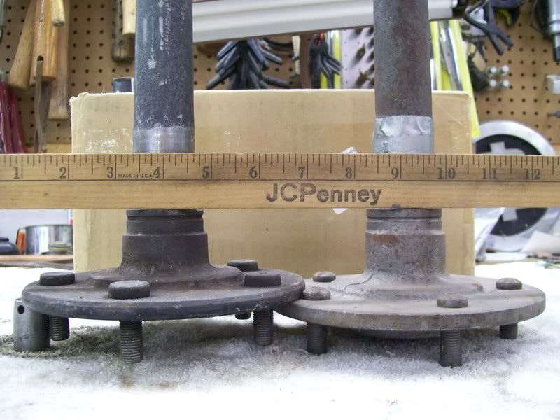

      Below shows the additional length of 59-64 pass car axles.
